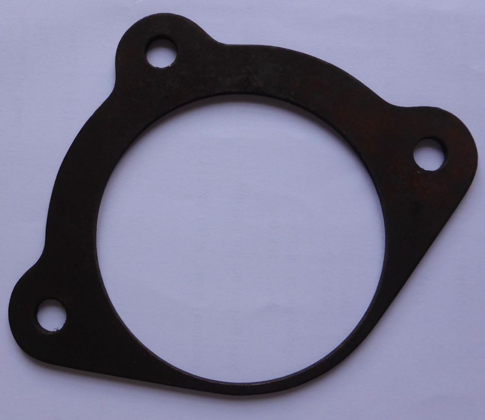

Nigel, is that the flat steel ring with three lugs on it for the starter bolts? If so I've almost certainly got one and will post a photo sometime over the weekend.
2495 Posts
Posted - 26/08/2017 :  16:04:24  Show Profile
Here you are Nigel; £10 to include postage?

How thick is this spacer?
Nigel
2495 Posts
Posted - 29/08/2017 :  15:41:47  Show Profile
Hi Nigel,
My ancient callipers say 15/128, so I guess nominally 1/8 inch.

Is a "P" type supposed to use one of these?
Can't see one in the parts list.
If so do you have another one, please.
Thanks.
2495 Posts
Posted - 04/09/2017 :  10:01:54  Show Profile
Well Michael, I think not. I got mine years ago because the owner's manual shows one however, on stripping everything there wasn't one on the car and it had worked just fine, so the spacer went into a box and was forgotten. It's still going fine without.
I've just re-read the bit in the book and it actually says there is a spacer so I think I'll leave it for expert comment. I do think though that some of the bits of the manual, certainly in the early editions, are cribbed from the J one which might explain its presence?
In fact, in the end Nigel felt that 1/8 inch was too thick so he doesn't want it. Should you decide otherwise, you're welcome to it.
1949 Posts
Posted - 04/09/2017 :  15:20:02  Show Profile
You can check to see whether you require a spacer by removing the starter motor, measure the length of the shaft from the end face of the shaft to the motor flange face which engages with the flywheelhousing face. Then measure the distance from the motor face on the flywheel housing backwards internally into the gearbox bellhousing until it touches the back face. The difference between the two measurements will give you the amount of end clearance available. You may be surprised at how small the clearance is!
