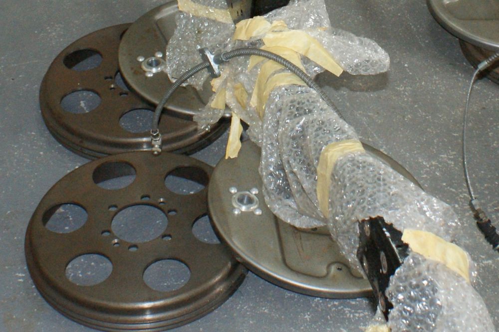

I am fitting 12" brakes to our J2/4 project. What are the size of the ventilation holes in the brake drums I have seen on other examples ? Thanks.

Chris,
The brake drums on my PB have six holes, each of 2 inches diameter.
I cannot be sure that this was the “standard” configuration, but it looks good and has stood the test of time.

Chris,
My J2 s/c has 12" brakes with six 2.5" holes and has given no problems.

Posted - 29/06/2018 :  07:42:51  Show Profile
Many thanks for your replies, Alan, Chris, Mike & George. I have decided to take Alans advice and go with 6 holes at 2" diameter, I am not aware of Alfins, but in with the parts in the Cyprus lock up were two 12" brake drums, very badly scored and non usuable. As most of the dismantled parts in the lock up were from Cottinghams J4129 I will assume that this J2 was upgraded to 12" and will replicate this.

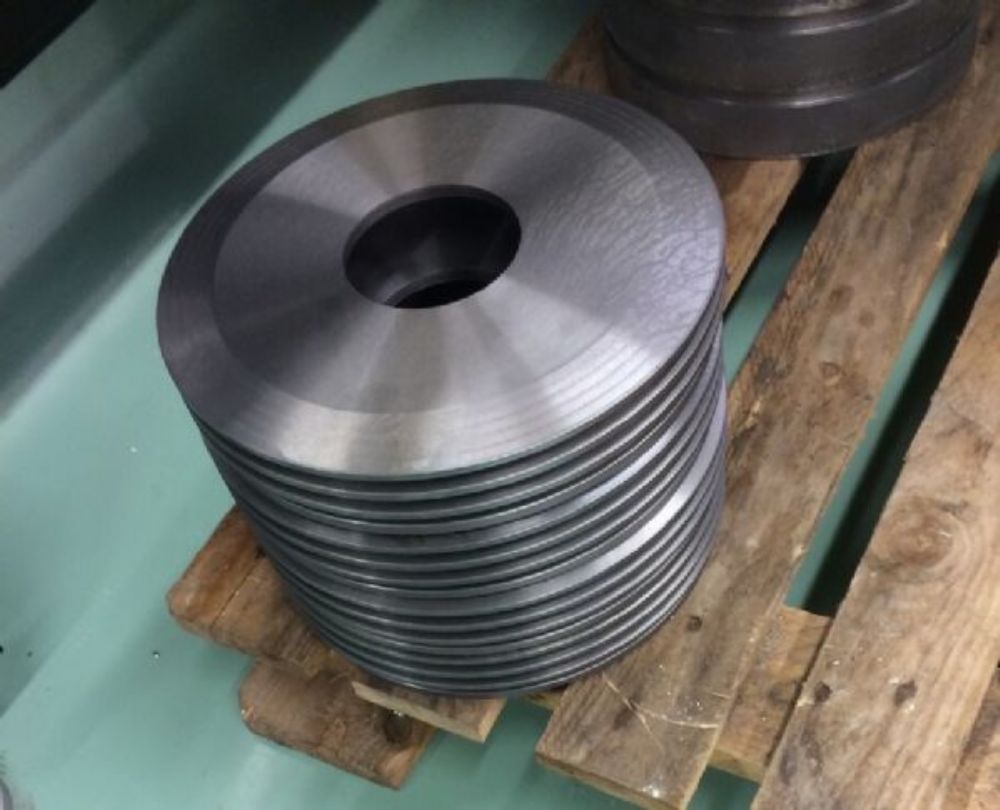

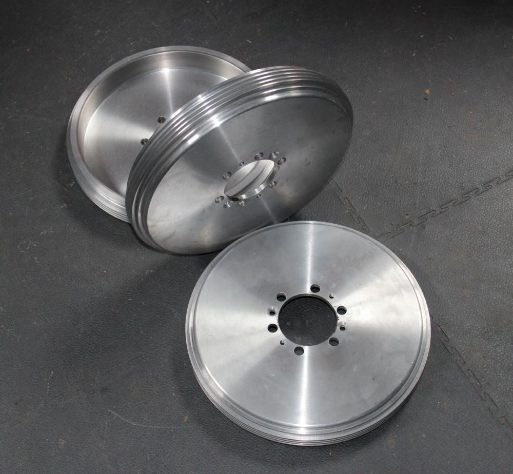

2471 Posts
Posted - 30/06/2018 :  10:46:09  Show Profile
Chris - photo of the 12 inch Alfin drums which I will be fitting to the L2. They are currently being machined to reduce the wall depth to 1/4 inch in the area where they bolt to the hub
The drums are manufactured by Typecast Ltd.

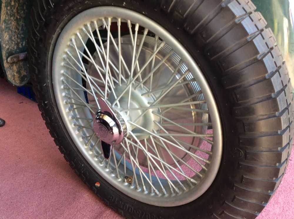

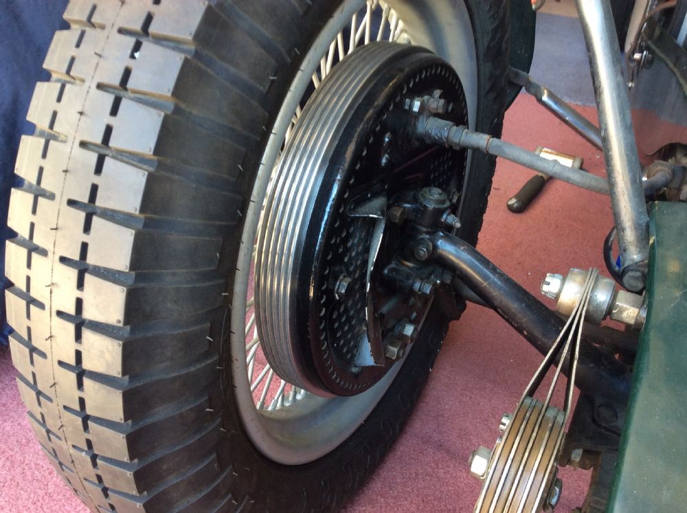

670 Posts
Posted - 30/06/2018 :  12:43:50  Show Profile
Hello, everyone.
Trying (again!) to post some pictures of my Alfin drums on my NA Special.
670 Posts
Posted - 30/06/2018 :  12:47:57  Show Profile
Hallelujah!!
Yes, the brake hoses need changing. The car is subject to renovation and fitting of an NE tail in due course, also the IZ 97 Marshall blower to be rebuilt and refitted.

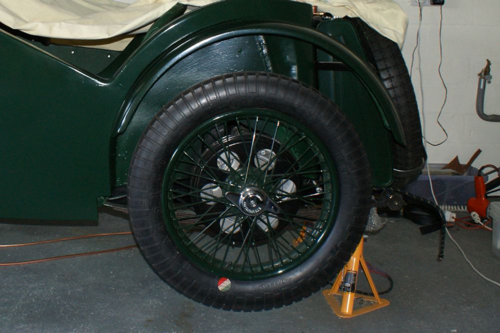

3278 Posts
Posted - 30/06/2018 :  16:52:14  Show Profile
Us J2 chappies don’t have to bother with such fripperies - we get finned brake drums as standard These are the splendid ones that Oliver Richardson did a few years ago.
