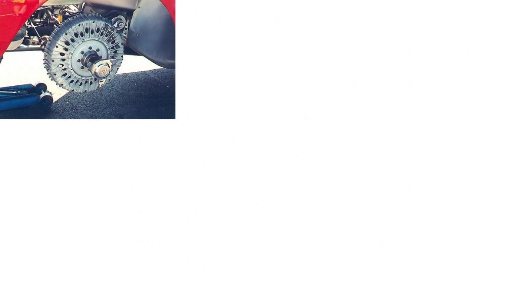

Posted - 01/07/2018 :  11:21:40  Show Profile
Hello, Chris.( MG Maverick)
Hope you received my Email and pictures.
Chris.

Posted - 01/07/2018 :  22:12:48  Show Profile
Chris (Westbury)
It looks as if your wheel center are touching the brake drum, I hope it is not.
Peter
670 Posts
Posted - 02/07/2018 :  10:21:24  Show Profile
Thanks, Peter.
I haven’t finally fitted the drums yet. I merely placed the drum in place for illustrative purposes only but full marks for observation !
Best regards,
Chris.

Bruce,
Again no factual data. The attached picture shows a Maserati brake drum with vent holes which certainly do not look like an afterthought nor fashion statement.
Whilst reducing unsprung weight would seem positive I am sure that the small difference in handling (for my J2 at least) would not be evident - the same would be seen that better heat dissipation may not give a noticeable improvement in braking for normal road use.
