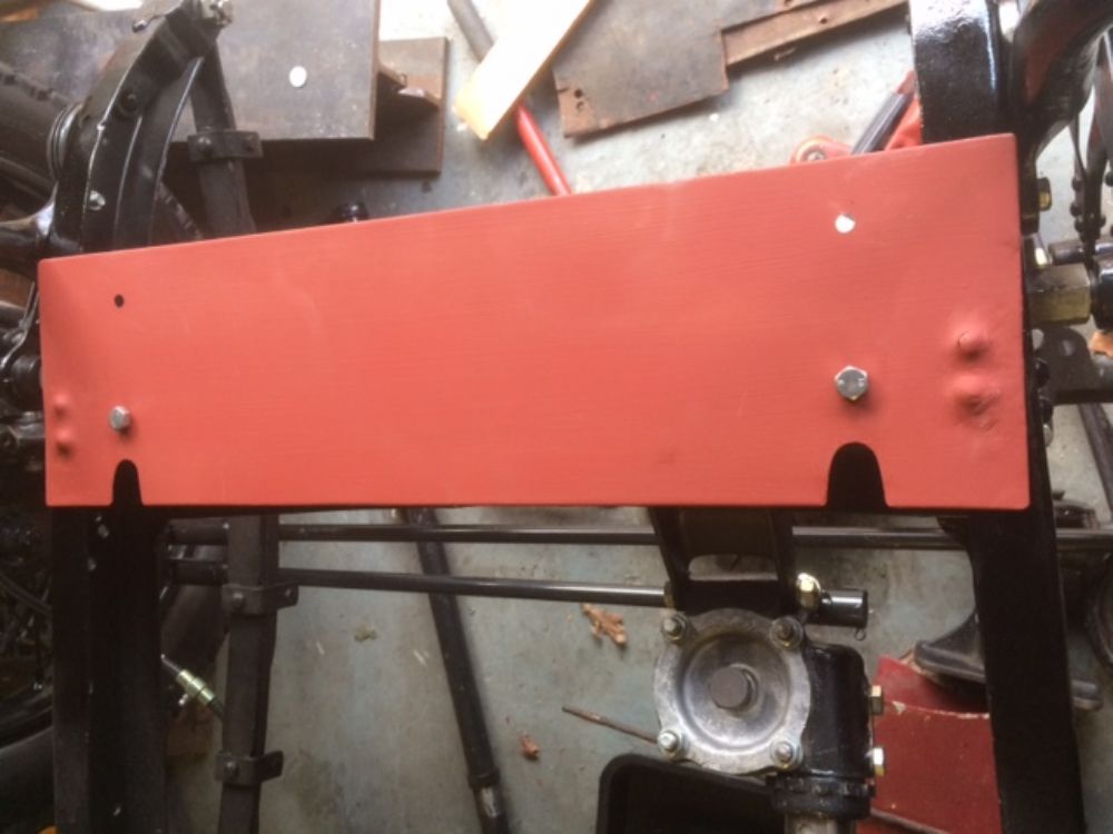

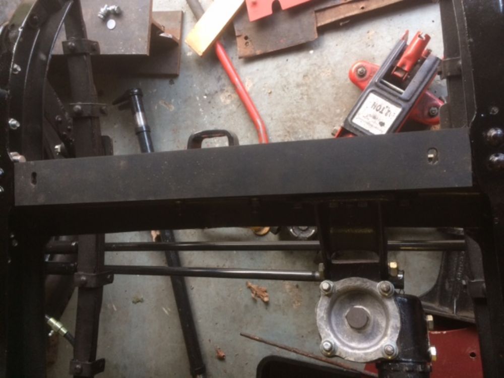

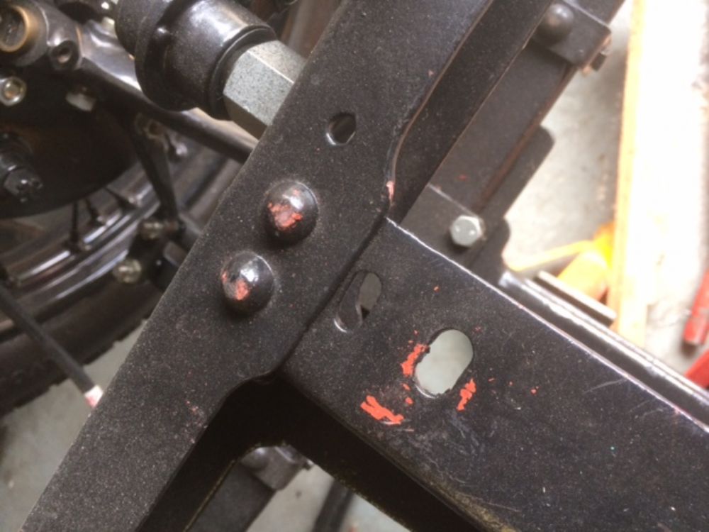

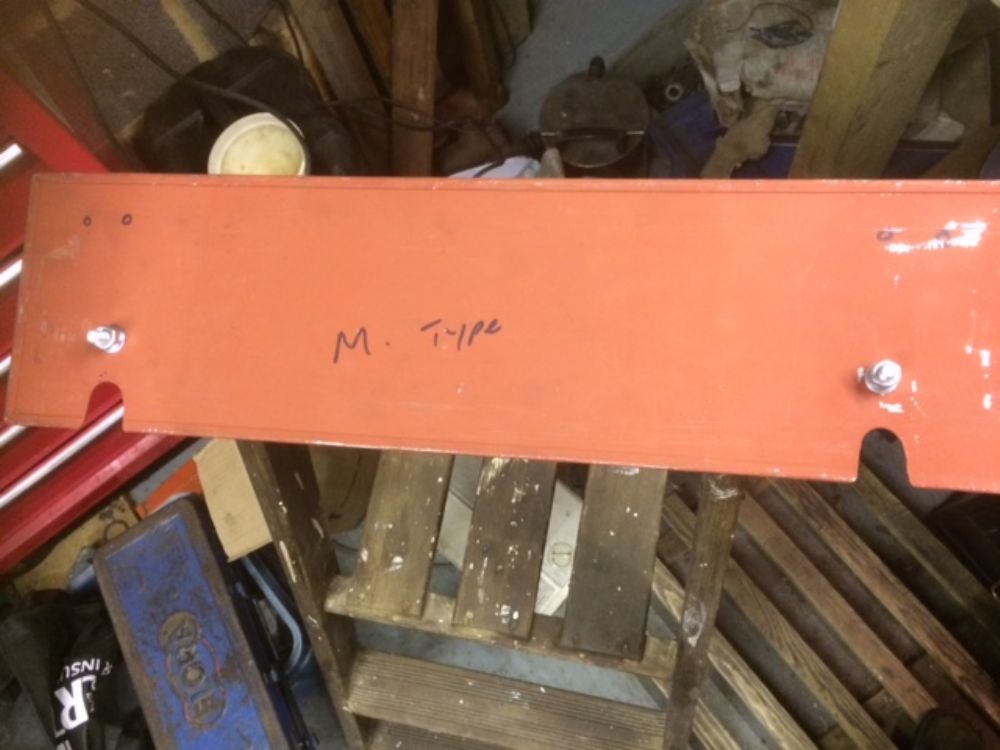

Not being familiar with Triple M cars I wonder if anyone could help with a little teaser. I have a panel, by Steve Gilbert, that goes under the radiator on my M type. Where it sits there are, on either side of the chassis two rivets holding the cross member in place (see picture). What is the usual method of enabling the plate to site flat? Are holes formed in the plate where the rivets are or should one form a dent in the plate.
One other thing, where the clips that hold the front valence in place, Steve has marked where this should be with two little circles (see picture), however my clips only need one hole, so should I place them in the outer hole, the inner hole or midway between them? Or doesn’t it matter at all, so long as they are symmetrical?

The other question, I form a dent upwards with a small ball pein hammer to clear the rivet heads

Garry, where the nuts and bolts are is the fixing for the radiator, the other marks are for the front valence catches. The panel as the picture, is upside down, looking as it were from underneath and the top of the picture is the front of the panel. Hope that helps.
It would seem that I have to practice my panel beating "skills" then! Would a bit of heat help?

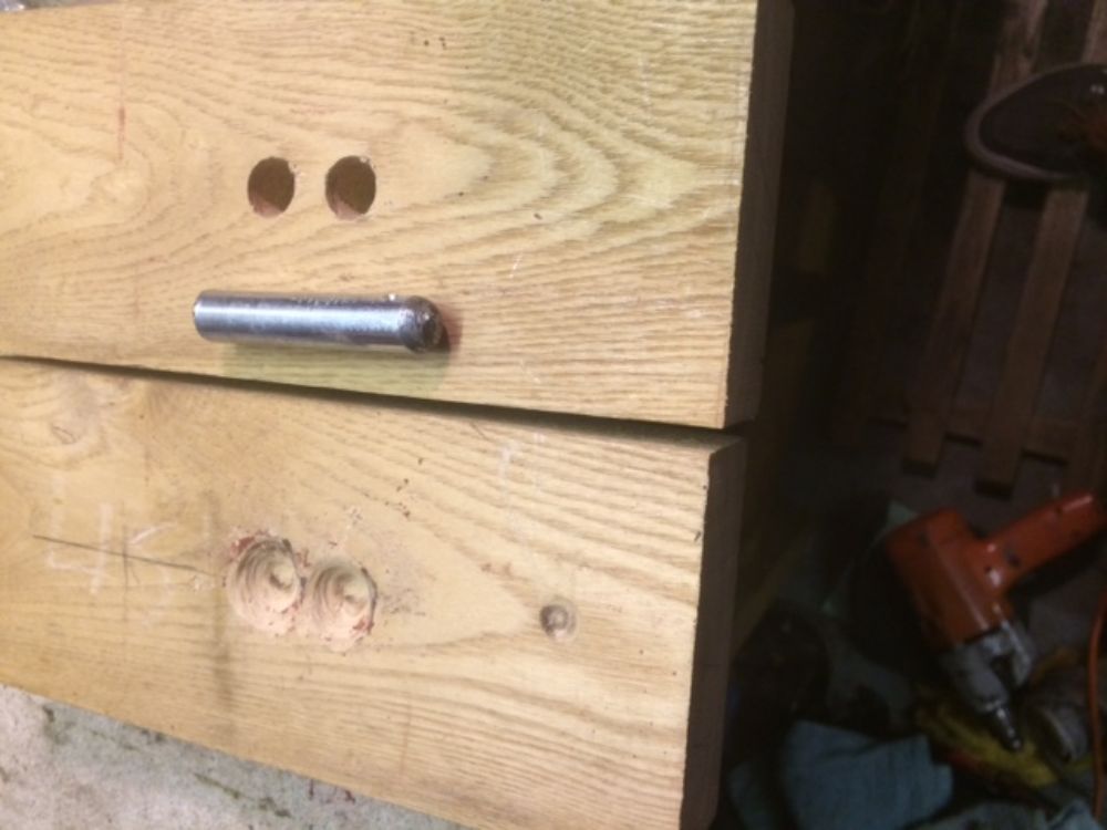

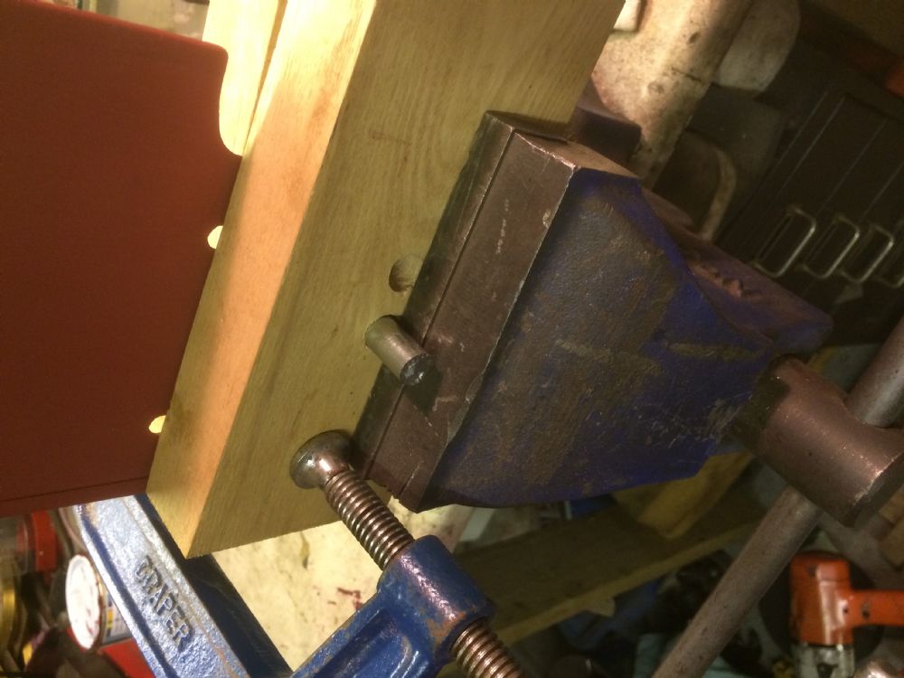

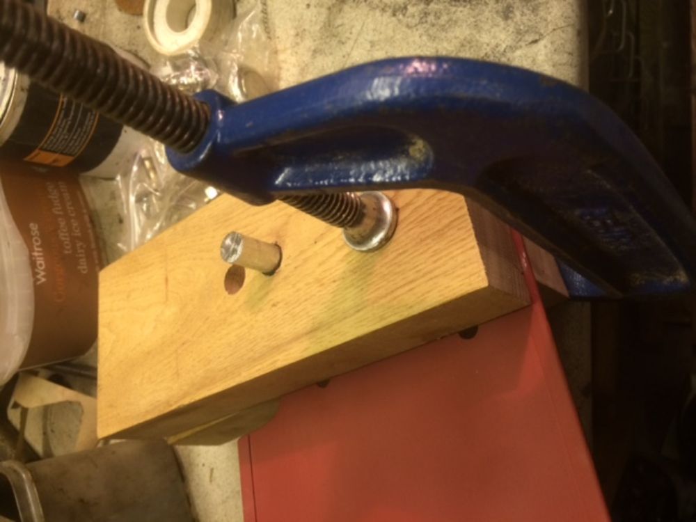

Well thanks for all the ideas etc. I have cracked it. I made a former for the indentations, using some odd bit of, I think, Maple which is quite hard. I made two indentations the correct distance apart, then with a piece of rod of suitable diameter I rounded off the end. Made a guide for the rod and placed the panel between the two its of wood, and clamped them together. Inserted the rod in one of the guide holes and pressed them in the vice, then the other hole and finally the other side. All as the pictures red oxided it and there it is in position with the rubber as suggested in the"Midget radiator and cowl" post elsewhere. job done many thanks.

Why is it back to front?

What's this dimple thing? I'm sure they just lie flat on the chassis,then it kicks up at the side a bit then flat again on top of the rivets.
