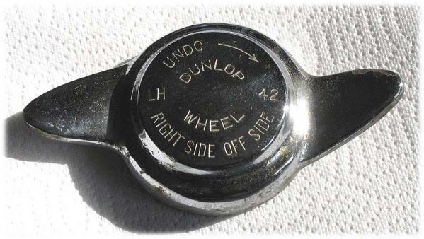

As a result of a visit to our local plating shop, it is becoming evident, that replacing all 4 knock-off spinners with new ones, will be less costly than re-plating the existing ones. But which one?
It seems that there are at least 3 ‘flavours’. The Rudge-Whitworth’, the plain old single MG crest, such as used on T-Types and then, there’s mine - the ‘Dunlop” variety - see below pic.
It would be of interest to me to learn on which models, each variety came. If I’m going to buy all new, I want to get the right ones.

Gordon,
Whilst I stand to be corrected, I thought that all MMMs should have Rudge-Whitworth.
JH

I thought they should be stamped with the Rudge Whitworth crest?
Not all MMM cars have knock off wheels though - the dear old M type has bolt on wheels.
I dont think that the DUNLOP ones are original fitment - but then again if they are replaced with modern copies they wont be original either?? ;)
I like Jeremy am willing to stand corrected but I think that the original fitment were either blank or Rudge.

I vote for Rudge Whitworth. J3017 has steel Rudge Whitworth crested knock-offs for the last 50 years. I will check into re-chroming costs. However new Rudge Whitworth knock-off nuts are not horribly expensive.
I think the Dunlop ones are probably for a non-MG.
Bob Canada

Before deciding to buy new spinners, because of the high costs for re-chroming, I think it is worth to consider, that the new ones are made of brass or bronce, and have not such a strong thread as the old steel spinners, and are much easier damaged by using a hammer.
Gerhard

Well, mine are definitely steel (used a magnet to check).
The chorme has come off the k/o in the picture; otherwise the remaining 3 are in quire good shape. In view of Gerhard's comment re brass, I think I'll stick with my Dunlop k/os and get them plated (but then again, plating introduces hydrogen brittleness!)

For chrome plating steel, after stripping off the old chrome and polishing, its good practice to copper plate first (then re-polish) before proceeding to nickel and finally chrome plate.
The k/o spinners are that substantial that hydrogen embrittlement through the plating process ought not to be an issue.

I am pretty sure that the early cars -D,J,F,L,K and PA/NA all had the Rudge Whitworth knock-offs. (M Types had there own Aluminium 'M.G. badged wheel cap). I believer the PB and NB had the M.G. Motif on the spinners. Modern sprinners are made in Aluminium Bronze which is very strong and chrome plates very well and of course will not rust. As Gerhard says they do not like being hit with the copper end of a copper/hide hammer however.
