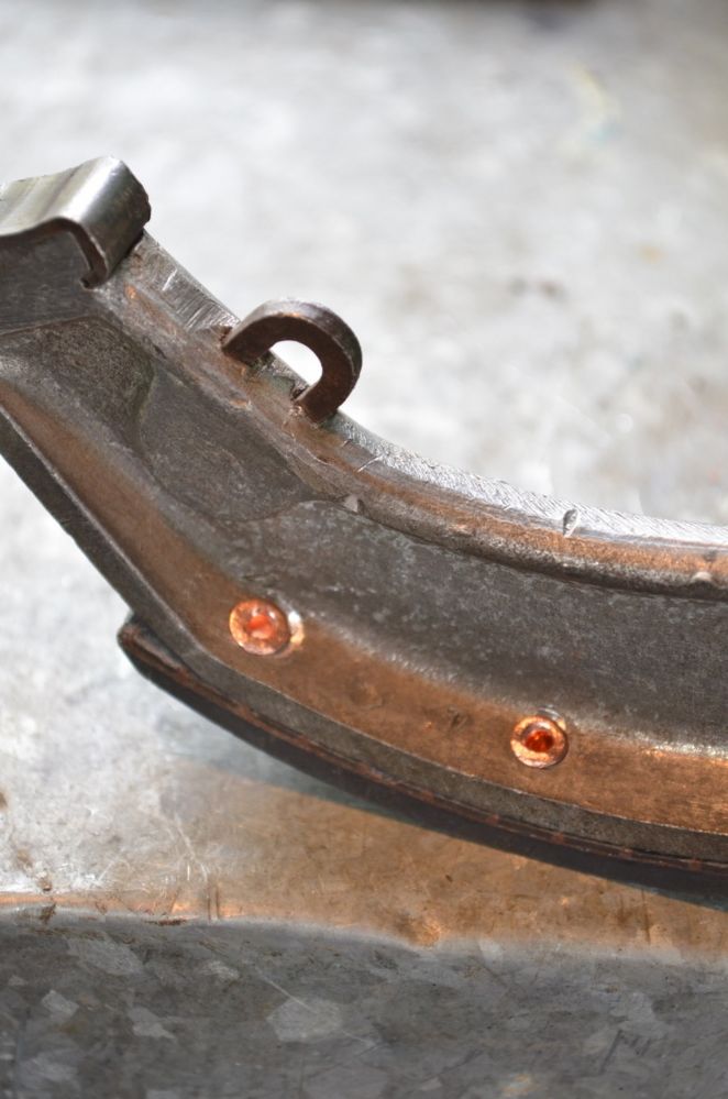

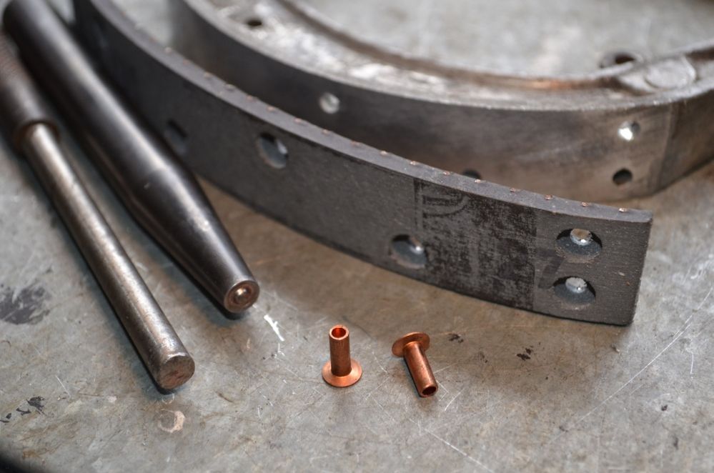

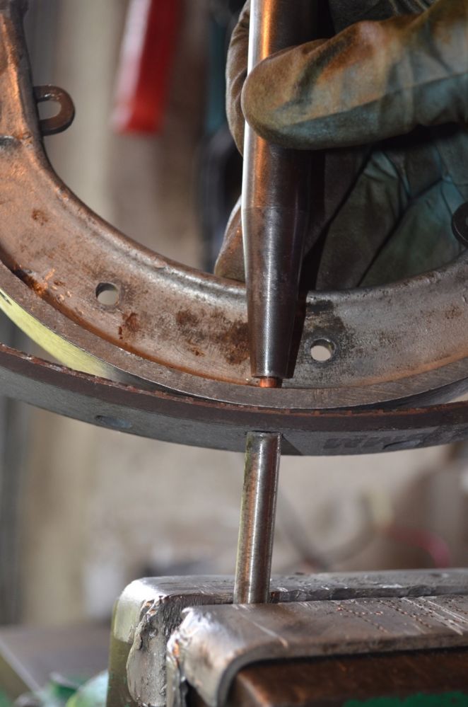

So it was back to DIY, which I really wanted to do anyway.....
To supply the correct rivet punch, I had very prompt service from Auto & Industrial Services of Arlesley, Bedfordshire (01462- 834778). I was advised which of their three punches was the right size - they even knew which size rivet was for 1932 J2 brakes!
Punch arrived next day and cost 14.40.
Didn't take long to do, just needs a little manual dexterity and only gentle hammering.
(After the linings were attached, I chamfered the lining ends)
Brian
