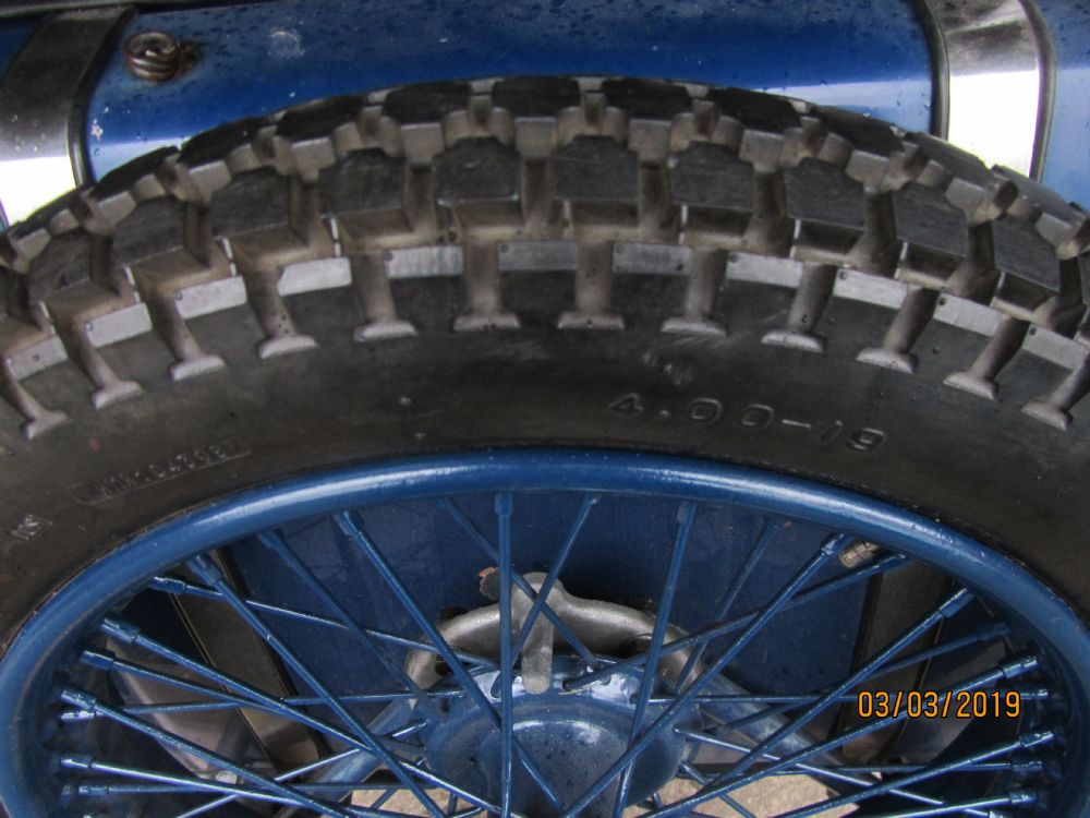

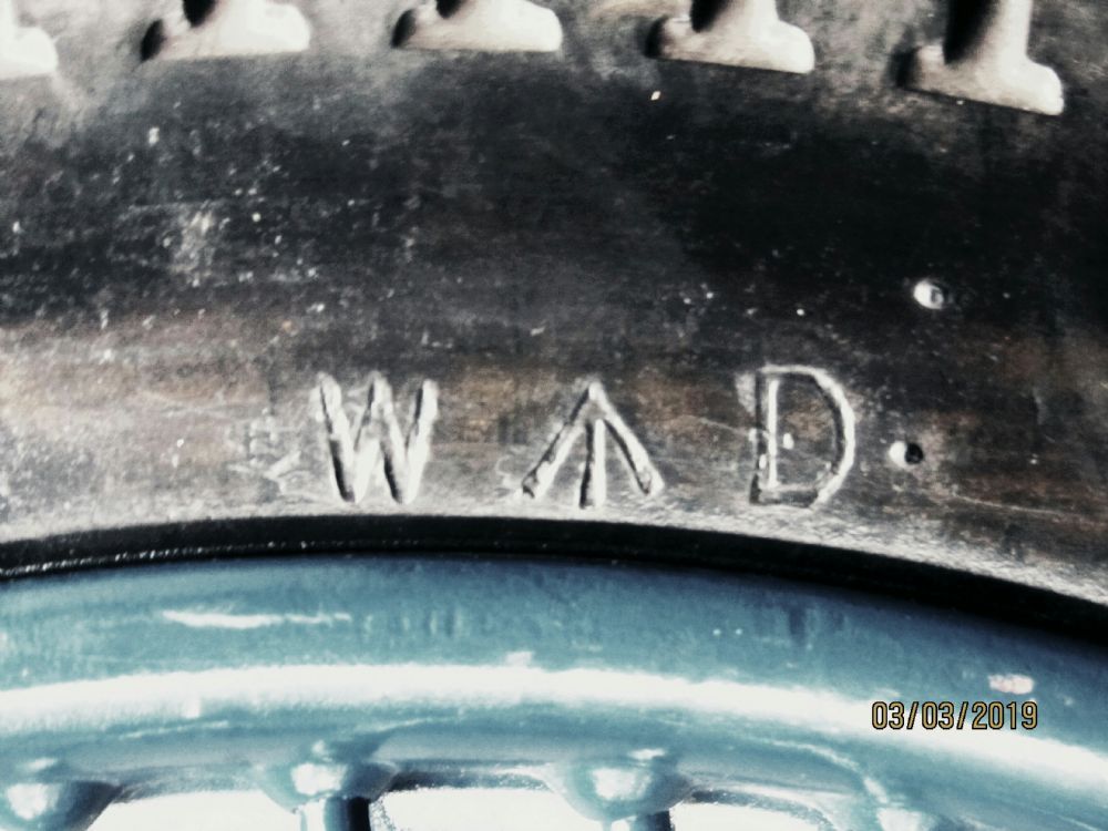

Bruce Sutherland asked how long our tyres last in use. Here is my story.
When I bought my PA in the mid 1960's, the cost of a set of new Dunlop's was more than I had paid for the car. So I went to my local Army Surplus store and bought a set of five 4.00-19 Firestone's for the princely sum of £2-17-6d each. I can't remember if that included tubes. They looked very period on the car and it handled beautifully. I did use other tyres for racing and trials, but otherwise the Firestone's have been used regularly on the road until very recently. Just a few years ago I thought they were looking a bit tired, and invested in a set of 4.50-19 Blockley's. The best of the Firestone's I gave to a local chum who has a J2 which doesn't do many miles. That just left one of the originals which had always been on the spare, and where it remains now. It has been called upon only rarely - I suppose I should have rotated them. Here are some photos I took yesterday.
There are no apparent signs of cracking or perishing. Apart from the familiar ex-WD broad arrow, it bears the legends "Firestone 4.00-19 gum dipped all non skid Heavy Duty" There are also some white stencilled numbers whiich I am told were army store numbers. The tread remaining is 9mm which compares with my measurement of 6mm on a brand new 4.50-19 Blockley - I wonder where that will be in 70 years?
So, some questions. In view of the new 6 year rule, should I throw this tyre away? It does seem a pity. And according to Tony Dolton, my local tip will charge me £2.00 for the privilege.
Did anybody else buy ex-WD tyres in period and are they still in use today? There was a large heap available when I bought mine.
Does anyone know what military vehicles might have used 4.00-19 knobbly tyres in war service?

John , they would have been used on most of the War Department motorcycles. My Triumph TRW had them , and after cutting one on a sharp kerb , I indented for one via MOD Ordnance sources and had great difficulty getting one . So scarce in the 70's even within the Ministry of Defence ! I would now love to find a set for my M type.
