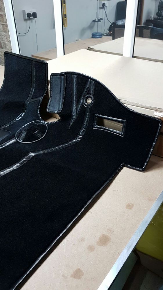

So everyone is aware: This weekend I am test fitting the first (pictured) completed carpet in a P-Type in Leeds so I can check it fits etc. and excuse the trimming pun, nail it.
Once we (I have someone highly skilled to help me) are happy these will be made.
To order just email me collingburn@btinternet.com and eventually I will reply.
NOW IS THE TIME! for these to be made, so tell your fellow P-Type owners worldwide.
It is very expensive carpet so if you want extra bits over the length of transmission tunnel etc then just tell me but they are charged on top, not included in the price.
These carpets are an absolute pain, infact the most complex thing I have ever made hence why most trimmers won't touch them with a bargepole. So they will be expensive, it can't be helped but they will be great.
To begin with: Carpets in Black wool carpet (Wilton) only for 2 Strs, RHD P-Types.
All other variations are further down the line.
James Collingburn

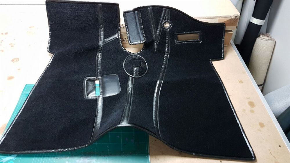

Carpets for P-Type 2 seaters only update.
Firstly, thank you very much to fellow Yorkshire man Terry Hartley, a lovely chap, who kindly let my colleague and I get inside his beautiful cream P-Type to poke our noses around.
The previous owner had just laid carpet in Terry's car to cover the floor, it wasn't one of these so we couldn't compare.
On the whole it fits very well and answered a few questions. We've come up with the best solution for the extra bit that goes along the length of the transmission tunnel up to the diff/under the seatback. Also a piece of sound deadening material under the seatbases/seatback but behind the wooden slat on the floor won't do any harm but I don't think we will be binding those as you don't see them. More labour = most cost to customers and I am trying to keep it down but do it right.
I will put up pics when we have finalised it as I don't wish to confuse at the prototype stage.
Can you all do me a favour, please refer to the photos of the carpet earlier in this thread.

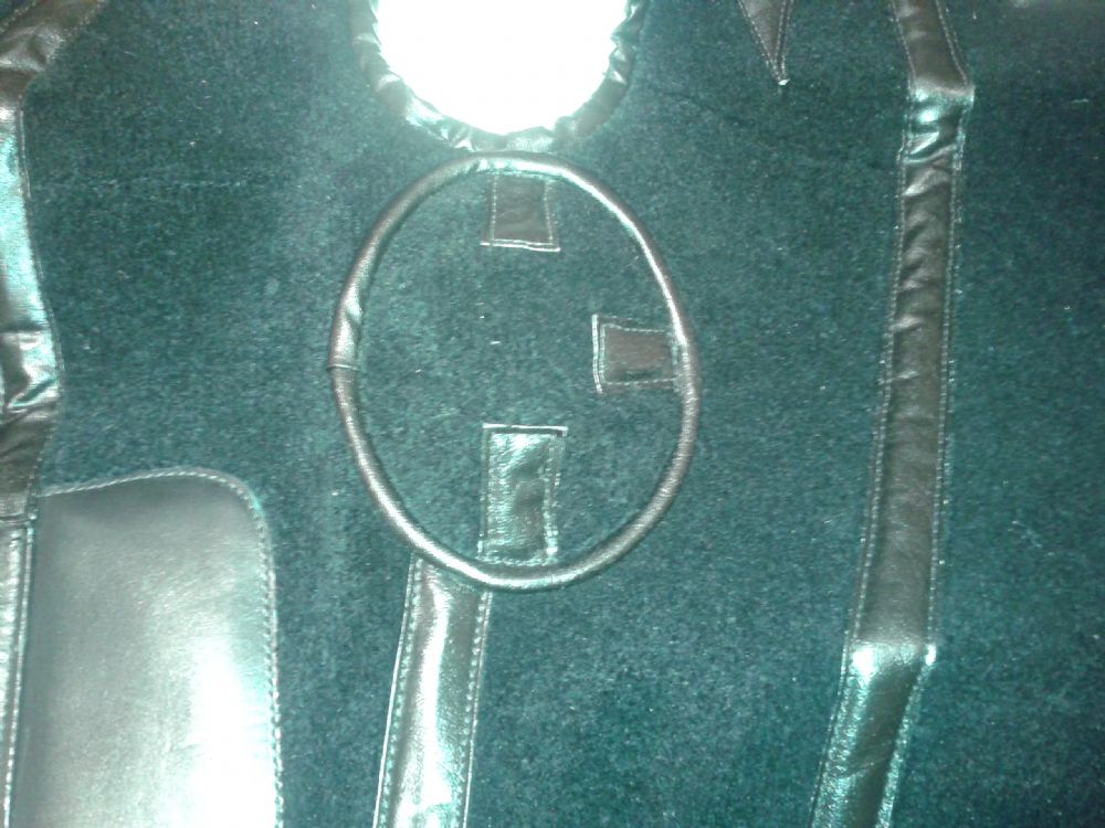

Does the carpet need to have the elaborate skullcap on or not? Going off Terry's car the only thing that passes through that area is the speedo cable. It goes through a hole in the carpet underneath the skull cap so we don't understand why it is there in the first place?
Purely from a trimming point of view those skull caps take 45-60 mins to make well. If we don't have to make them then the cost of a Collingburn P-Type carpet reduces by an hour's labour which saves you money.
I just asked my Dad who used to be the No.1 expert on all these things, please keep in mind he is nearly 71 and Parkinsons has affected his thinking, he said: "The reduction gearbox on early cars Js, Fs and Ls was smaller so you didn't need the skullcap.
the reduction gearbox was bigger on later cars Ps, Ns etc. so the skullcap was introduced".
It just seems an excessive amount of labour to make this skull cap when you have to either crudely cut or punch a hold in it anyway for the speedo cable to come through.
The skullcap is sewn to the carpet below, it isn't partly sewn or left free.
The sooner I'm convinced it needs or doesn't need to be there the sooner we will make more.
I'm all for keeping things as original as possible but I don't want to waste valuable manufacturing time on something not needed.
Regards James Collingburn

thecollingburnboys
401 Posts
Posted - 08/01/2017 :  19:20:15  Show Profile

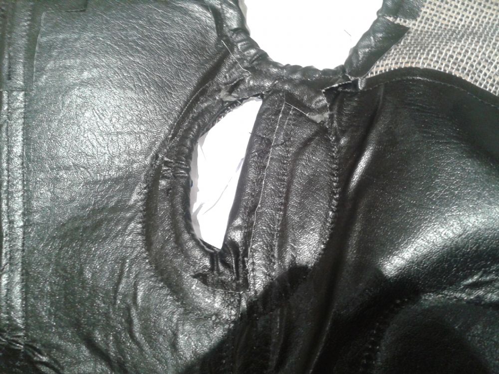

Why the elaborate skullcap when all that passes through that area is the speedo cable?
The other photo is the underside showing the D shaped hole, this is the underside. If we ditched the skullcap completely this would look neat and pretty from above.
1668 Posts
Posted - 08/01/2017 :  19:31:44  Show Profile
Hi James,

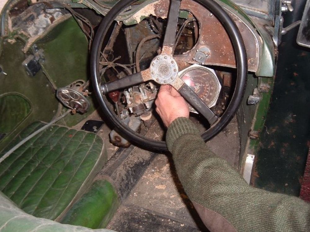

Two answers, certainly as far as I know, firstly as I understand things the tunnel was originally in leather to match the seats as this which is the well known "barn find" P that was sold a year or two ago by Sussex Sports Cars:

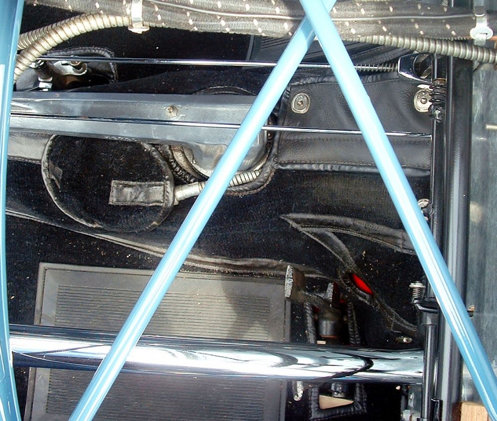

Secondly it may well be that some people will need the skull cap and others not. The P originally had a 90 degree angle drive to carry the speedo cable forwards to the bulkhead where it exits the carpet where the right hand side flaps over the left:
This is my car and I certainly need the cap as the top of the angle drive is quite a way up from the line of the shaft tunnel, and clearly it was meant to accommodate this. Quite a lot of people do away with the angle drive and carry the cable straight up from the gearbox. I would imagine they would prefer just a bound hole for the cable to pass through, but obviously they must speak for themselves.
1668 Posts
Posted - 08/01/2017 :  19:43:14  Show Profile
Ah! You posted again while I was doing mine. I had always assumed (what do they say about that?.....) that the angle drive was completely covered by the skull cap and the cable, as I said above, went under the carpet to the front. Looking at your new pics I guess the angle drive is covered but the cable passes out through the D shaped hole and goes forward above the carpet.
Even if that is the case I would still prefer to pay for the cap on my own carpet as this seems to be the original arrangement. If I was not going to have it, I might as well just carpet the floor and leave the gearbox uncovered, which I could easily do myself!
Bruce Sutherland
946 Posts
Posted - 08/01/2017 :  21:36:01  Show Profile
Carpet over speedo-cable right-angle drive...........like this:
Bruce. (PB0564)
thecollingburnboys
401 Posts
Posted - 08/01/2017 :  22:01:59  Show Profile
Thanks for this guys.
I know I'm being pedantic here but you have to be when understanding "why did they do that?"
I still don't really see what the cap actually does. Does it protect anything or stop something rubbing against something else? When it comes to this you guys know more than I as you own the cars, I make stuff for them very well but because I supply customers all over the world I do it without the car. I really do appreciate the info by the way, a massive help. I'm sure you can appreciate I want customers to be happy and no carpets coming back to me not right.

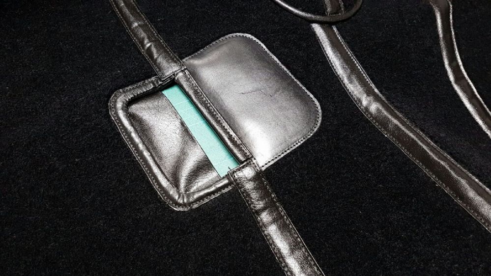

So why the 3 rectangular pieces of vinyl sewn on? It just seems overly complicated to solve a simple solution.
Edited by - thecollingburnboys on 08/01/2017 22:20:04
DDMDSN
261 Posts
Posted - 08/01/2017 :  22:21:35  Show Profile
Looks great, well done James.
I recommend the skull cap as it looks right and adds to the character of the car.
Remembering there was a difference between PA/NAs and PB/NBs where the speedo drive on the latter cars runs the speedo, whereas on the earlier cars runs the odometer. I'm not sure if the angle drive is needed at least on earlier cars, and know a number of PA owners who choose not to use one.
Donald
PB0759
thecollingburnboys
401 Posts
Posted - 08/01/2017 :  22:38:50  Show Profile
Ignore me, it's getting late and the red wine is affecting me.
The 3 sewn on bits of vinyl are a strengthening as the carpet is slit underneath. I know this, we made it haha.
Oh well, at least I've taught you guys something.
Righty, time for me to come off here for tonight me thinks :-)
PS thanks for the info it is greatly helping us fill in the blanks.
