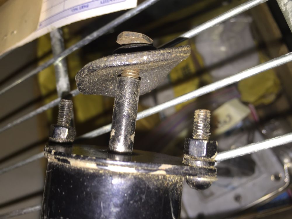

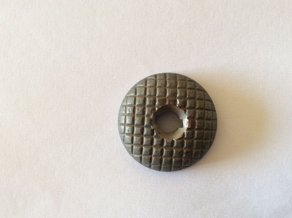

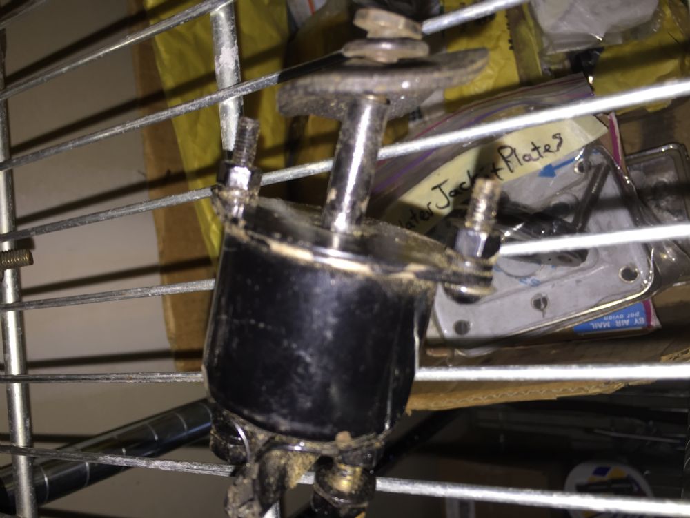

Having just acquired a starter button from one of our members I have a question. Is the slot in the screw hole for a spline?, or is it to prevent splitting when in use or some other unknown reason.
Pictures of new/old button and my old switch.
Your help please.

Yes Brian it's for the spline! If the rod on your switch hasn't got the lugs don't worry just fit it really tight and use locktite all its for is to stop the knob spinning on the rod then the screw coming lose.

So does anyone have a screw that is used for the button available? Mine is as is shown a hex bolt now...

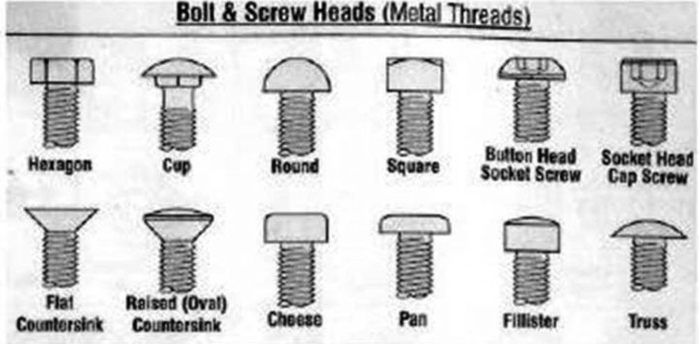

Brian, it should be a countersunk raised head slotted screw/setscrew.

I am quite familiar with various hardware names here in US as I own a furniture restoration company. I think this is what we refer to as a Oval Head Screw. The face being slightly domed and not completely flat. Or should it be completely flat?

Just looked up www.RestorationStuff.com page 36. They say 'Oval Head Screws have a slightly rounded top and are used in countersunk holes'.
YES! that is what we call raised countersunk. Should be a Slot Head Screw, but will probably be an English thread.

Set Screw head types: "A picture speaks a thousand words"
