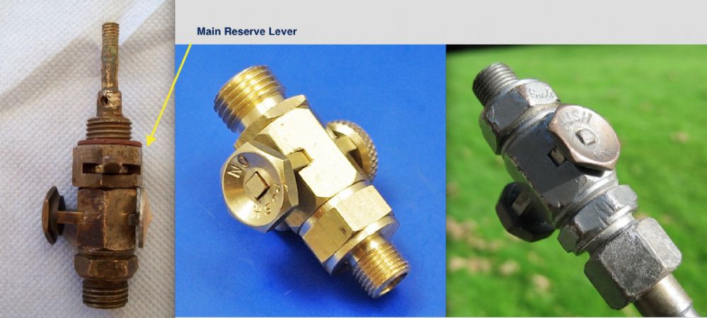

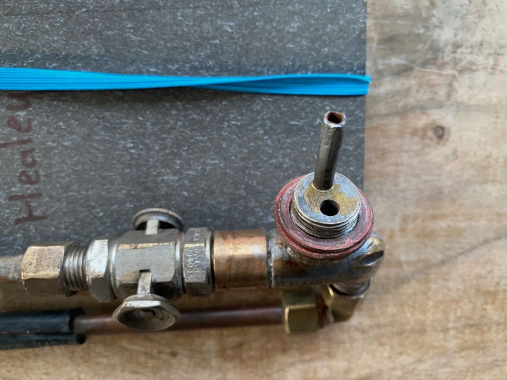

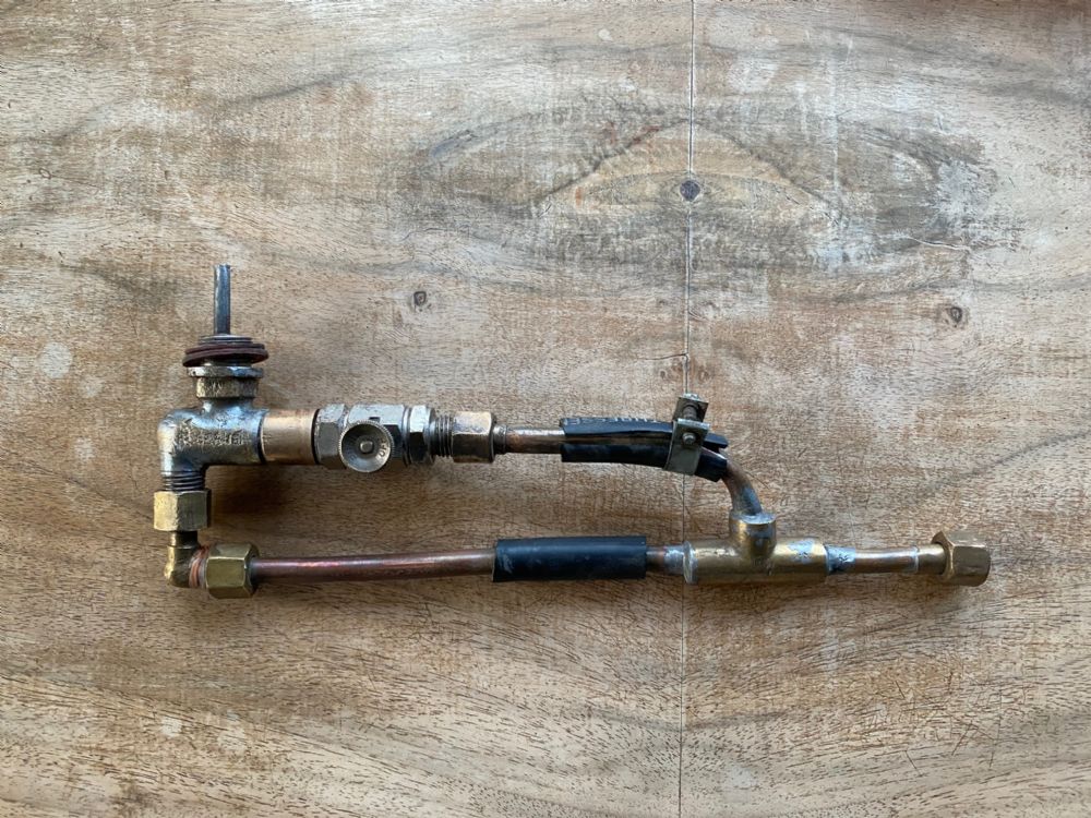

Is this set up in the picture below the original fuel tap above the passengers feet room? I can't understand how the reserve works. I would expect a possibility for on - off - and reserve. The tap obviously only turns on/off the upper fuel line. I have an additional tap on the fuel line just before the carburettor, but this is obviously not original and of course I need to open the bonnet every time.
What was the original MG M fuel tap solution?

My, my a genuine plumbers nightmare. Completely wrong but I suspect the bit that screws into the tank was once on an M before it was butchered. I donít have an original but will see if I can arrange a photo of the real thing to be posted.

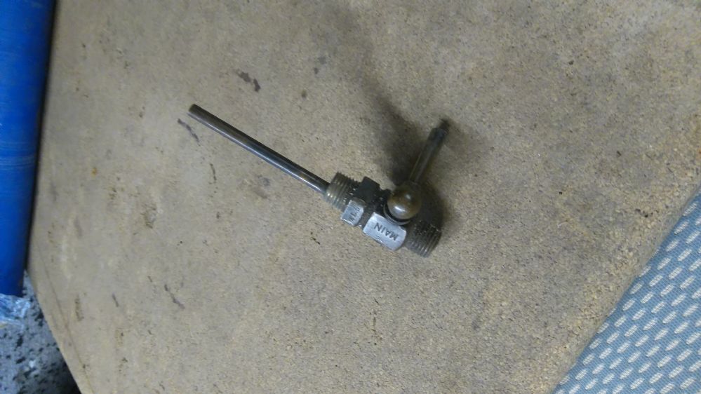

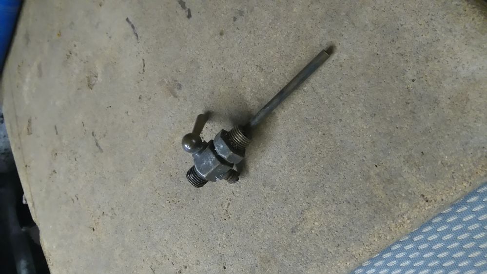

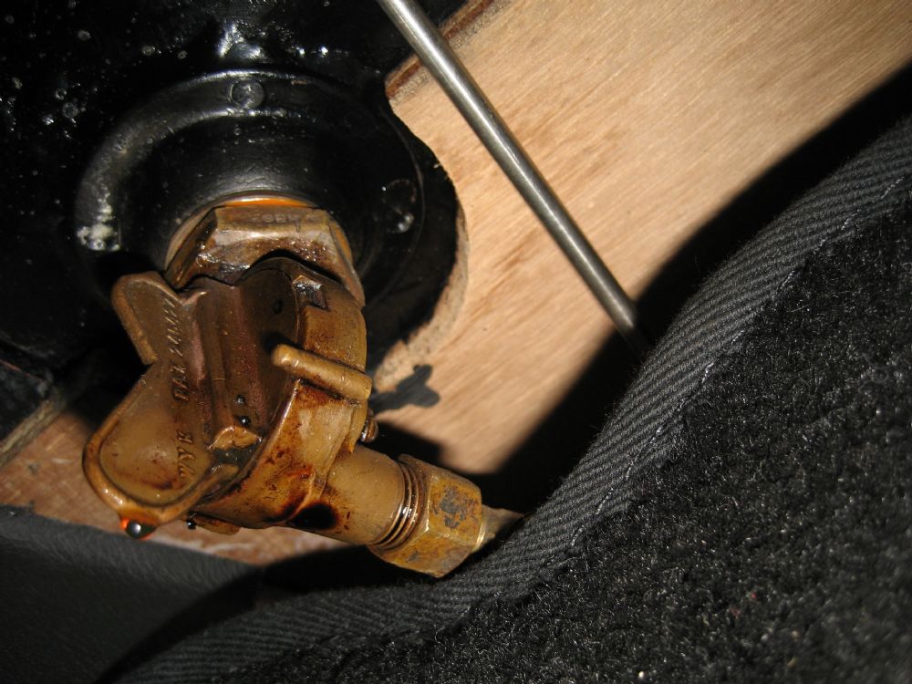

I don't think the M-type had a reserve. This was the valve which came off my M-type and I feel it was the original fitting without any special plumbing. I did not trust it.

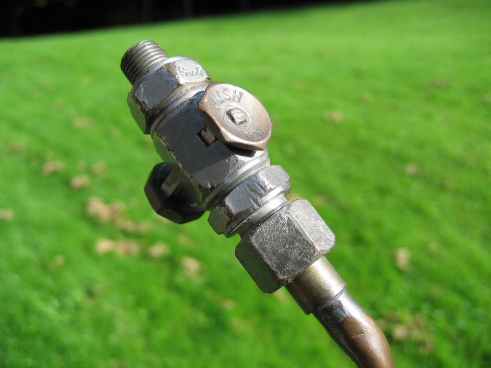

I used this OHC Minor valve which allows a reserve and I had this for a while. It seemed like a good idea.
As you can see, it leaked and rather than take any chances I replaced it with a modern valve which has given no trouble.

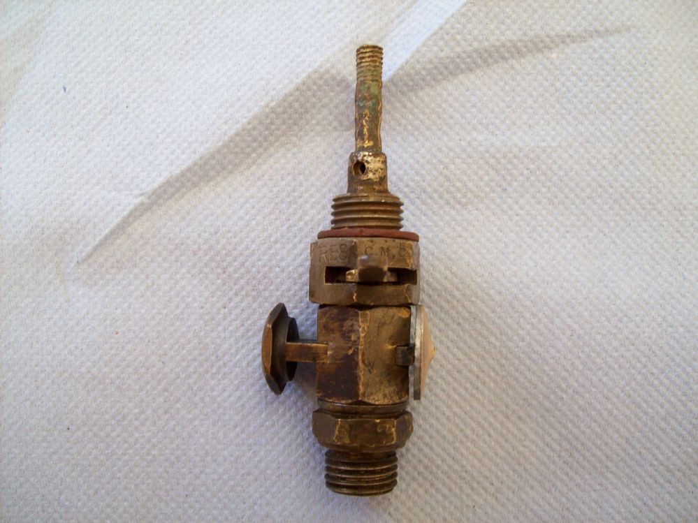

Sam's first photo shows exactly the one I found on 2M1281.

None of these are anything like the original. I'll see if I can find mine to photograph. The M does have a reserve.

So there was a reserve. The obvious choice of tap to do this would have been the type used on the OHC Minor which was something like this.

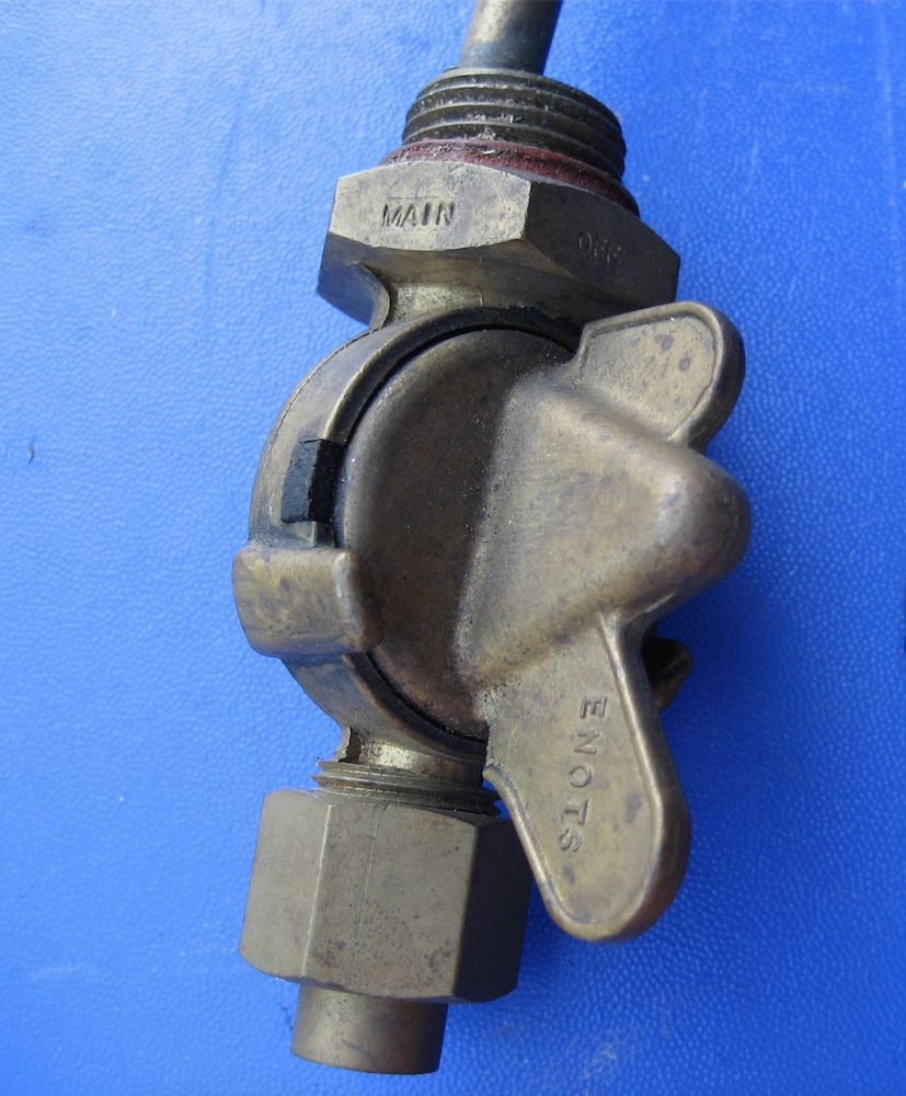

Hopefully I have attached a photograph of an original M type fuel tap. Made by Enots , the 'main' is the usual push-pull sliding unit , and reserve is accessed by moving the lever towards the RES marking , and this aligns the tiny holes at the bottom of the pipe.

thanks Fred, that is perfect. Does anyone have an idea where I could purchase on of these original m-type fuel taps.
