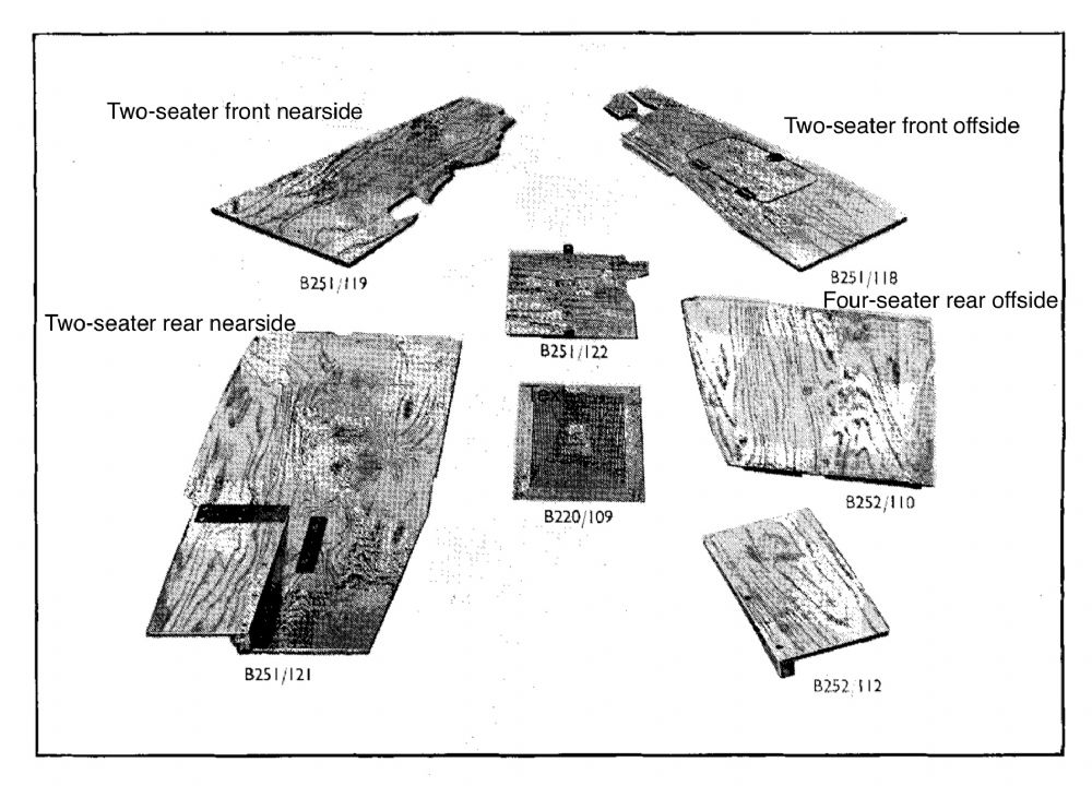

As ever, the Parts List is your friend! From the PA and PB Parts List.
P.S. Note the surface mounted hinges for the access panel!
Edited by - Simon Johnston on 29/03/2020 23:47:43

For J2 see Technical Article Number 187 Octagon Heaven.

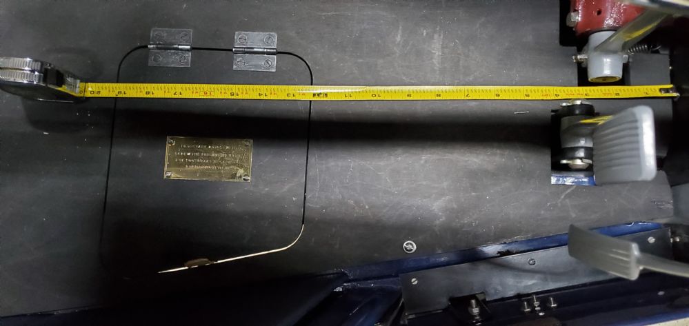

Our floorboard patterns are taken from a decent original pair. This shot may help.

Tom, is that a fabric lift tab at the opening side? Was that to be found on your original?

I remember mine as being leather on the P type . Whether that was original l cannot say but it was aged.

[quote]Originally posted by Ian Bowers
Ian,
Yes, but actually a leather tab. There's a small recess in the side of the door - I can get that dimension, and the leather was tacked into this recess in the side - 2 tacks. Not folded down under the bottom.
My leather was broken/torn/worn so I don't know what the complete pattern looks like. I do have 3 or 4 original leather tabs for the rear battery lid which was simply fastened with a #8 oval head screw with finishing washer.
Tommm
Ian,
Tommm
Yes please Tommm,
Dimensions for leather tabs for both the floor board door and battery lid. How many tabs for the lid and where are they positioned?
