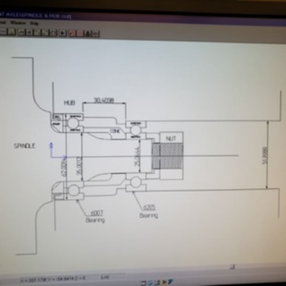

I've written a few threads regarding the design of my front stub axle which came oversized so the standard bearings, cones etc. did not fit. The machinist redesigned it as shown below. Back to ball bearing and a redesigned cone etc.
Any thoughts or input ?? Lastly, what is the thought on a porper torque for the outer nut ??
