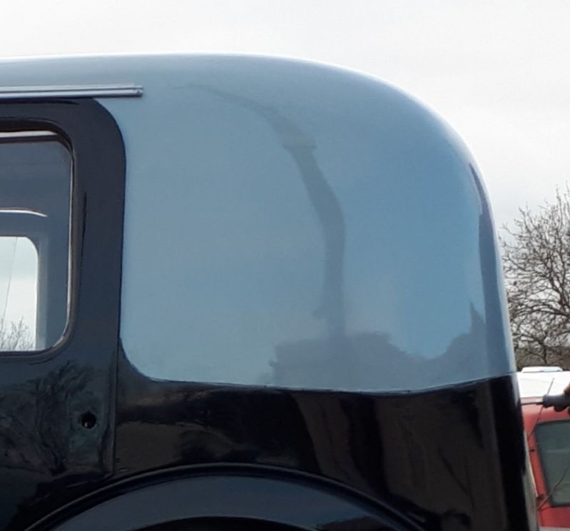

Salonettes have pin beading.
An absolute pain.
Chris B used aluminium because it was easier to work.
I might have to too.
Can anyone recommend a coach builder who can still do it?
It forms the gutters over the doors and boot and, the difficult bit, the thin strip that seals the join between the roof panel and the quarter panels... and isn't there!
Fingers crossed...

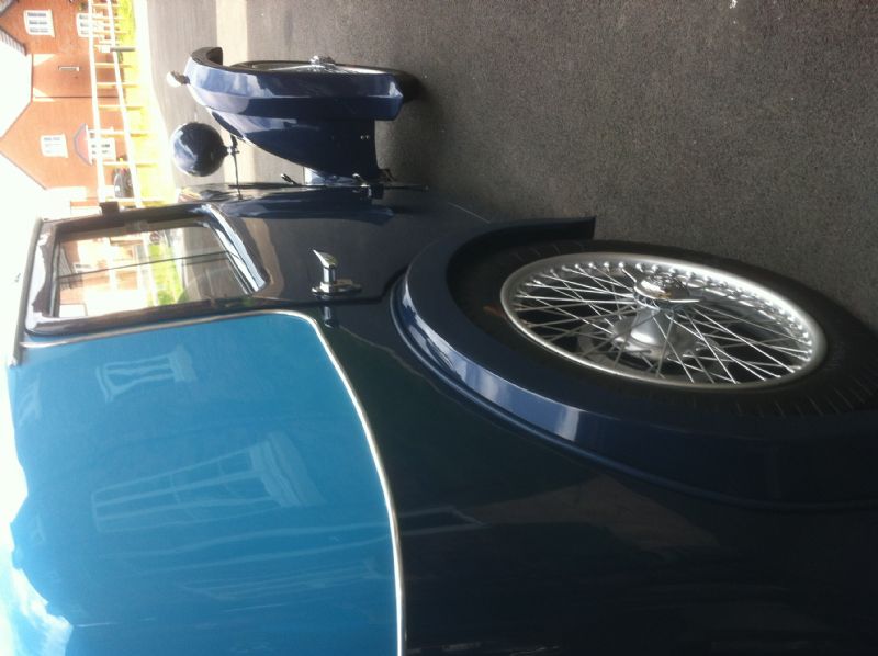

... yes it did work well Peter ...
