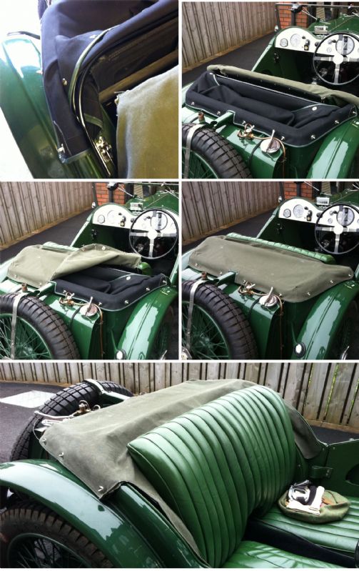

Each to their own, Bruce. I’ve been using (and abusing!) my Wigan hood, side screens and full length tonneau cover for over eleven years now and I’m absolutely delighted with it (the fabric that is, not the workmanship which was woeful). It has probably faded a bit (haven’t we all in eleven years?), but it hasn’t shrunk, not disintegrated. For sure the tonneau cover can become hard to stretch to get it fastened on all the studs but that’s because it wasn’t made correctly in the first place. But all it needs is a good soaking and then leave it to dry when it’s stretched over the Lift The Dot studs and it recovers. But the hood fastens perfectly every time and I don’t leave it erected if the car is not being used - it stays folded and stowed as in the picture above. But I will admit that I don’t fold it away when wet - I’d let it dry first.
