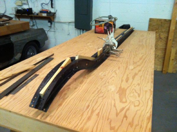

My first post to forum! We've broken down the chassis to straighten and sister the frame rails. Here it is prepped for TIG welding. We built the super-flat working surface to help verify our measurements while assembling the frame. J3663 (MG2762) was crashed at least 3 times during trials racing in 1934 according to the factory records!
