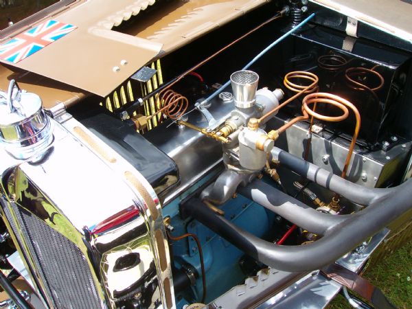

485 Posts
Posted - 30/09/2013 :  18:30:54  Show Profile
Not sure where it was, but Dani Ingold's car, the Stisted car in the 12/12, was at Silverstone in 2008. Difficult to see but on the bottom right.
