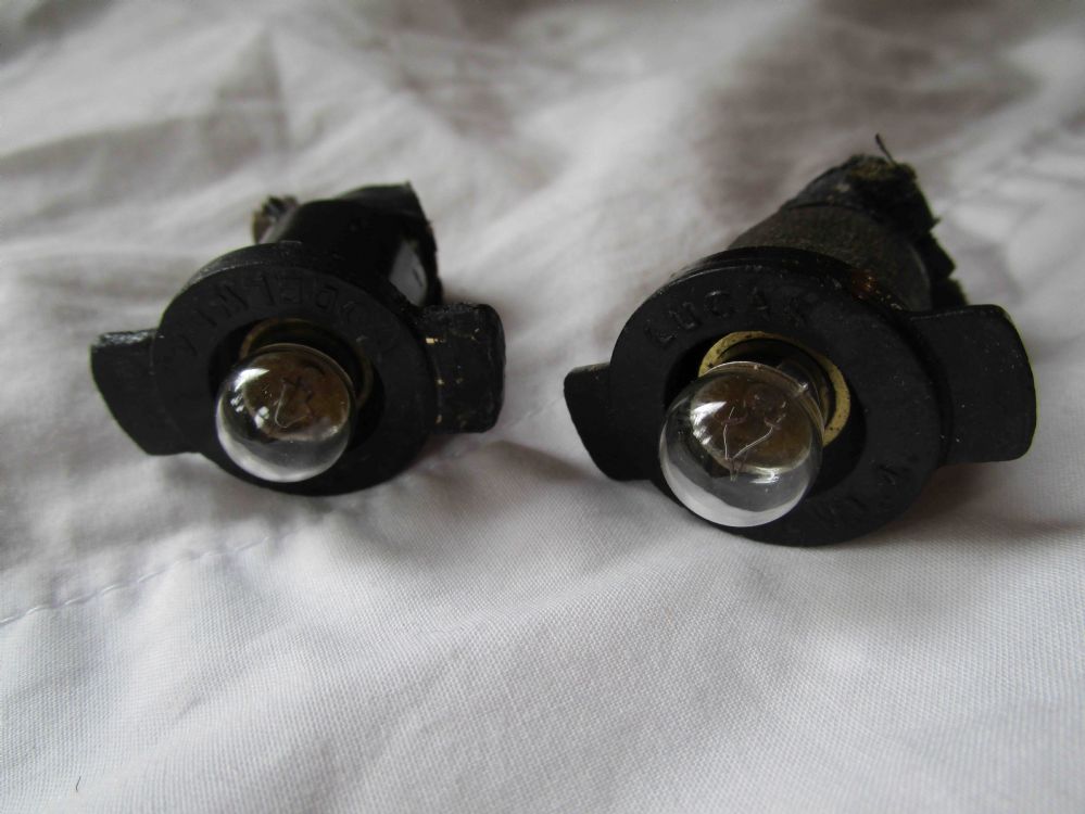

Hi Donald, how do you make the wings on the WL4 bulb holder?
DDMDSN
332 Posts
Posted - 06/02/2019 :  21:27:25  Show Profile
To add the wings, drill 3 small holes each side on the lip, and epoxy in 3 brass pins of the correct length. These are rested on moulding putty to hold in place until cured. Make a pattern off an original for the wings in moulding putty. Position the WL-4 in the mould, seal edges. Pour in black tinted epoxy resin. Remove mould when cured. Trim and file to shape. There is a 1mm lip on the top, this inserts in to the holder. In the photo below, the orginal is on the right, and the wings added on the left. The brass pins are just visible on one of the wings. The wingless WL-4s are a bit easier to find, as they were also used on Jaguar XK-120s
