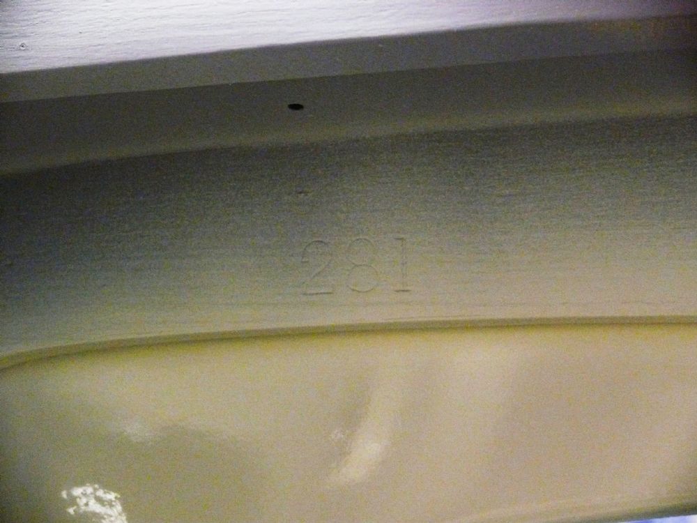

Nick, if your car has its original body you will find the body number, that is the last figure after the "/", stamped into the body timber above the passenger's knees thus:
I'm not sure if your PB is a 2 or 4 seater but my 2 seater PA has body type B251 and I would guess a PB 2 seater would have the same.
