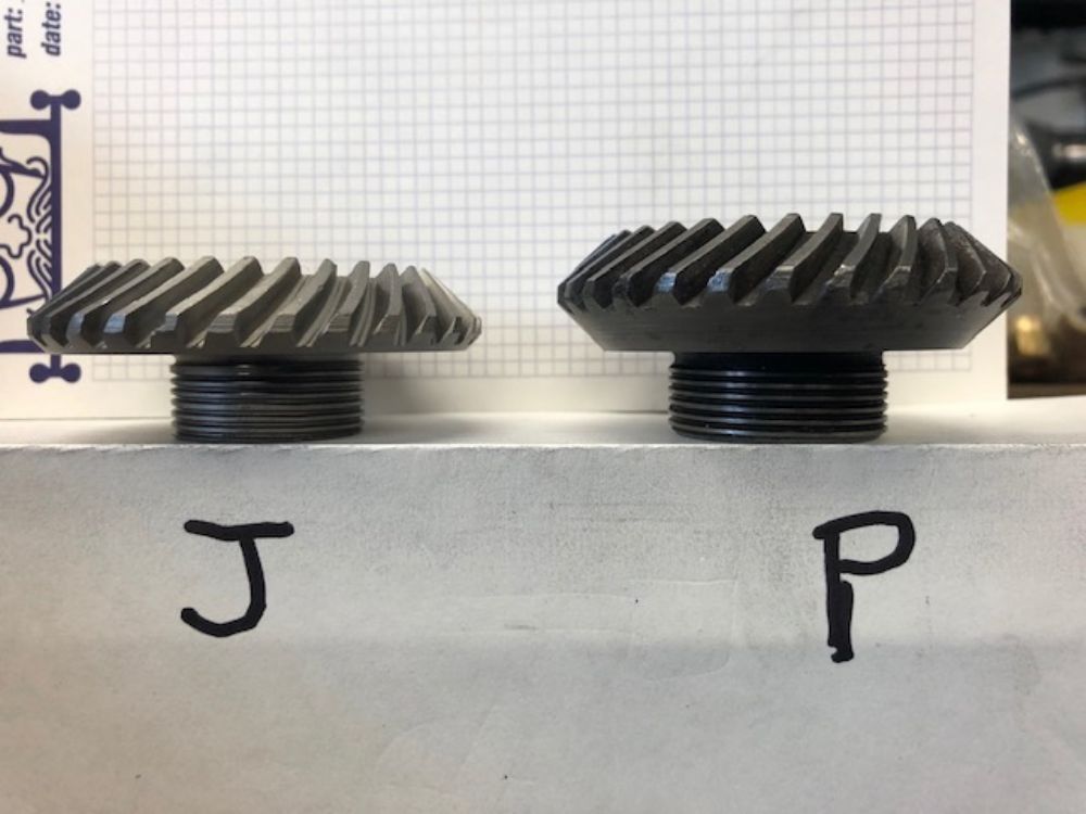

Hi David, thanks for the reply..... Smal cam (M C D J F) and your J3 had a shallow gear.... measure from top of gear teeth to flat rear surface less than 1/2" is small cam, more than 3/4" is big cam (N P Q R K L) ... makes the gear face look dished rather than flat! FOZ |

Hi Foz, sorry but it is a J type gear, that I will now keep as a spare.
Thanks for the helpful photo, Chris. Regards, David |
