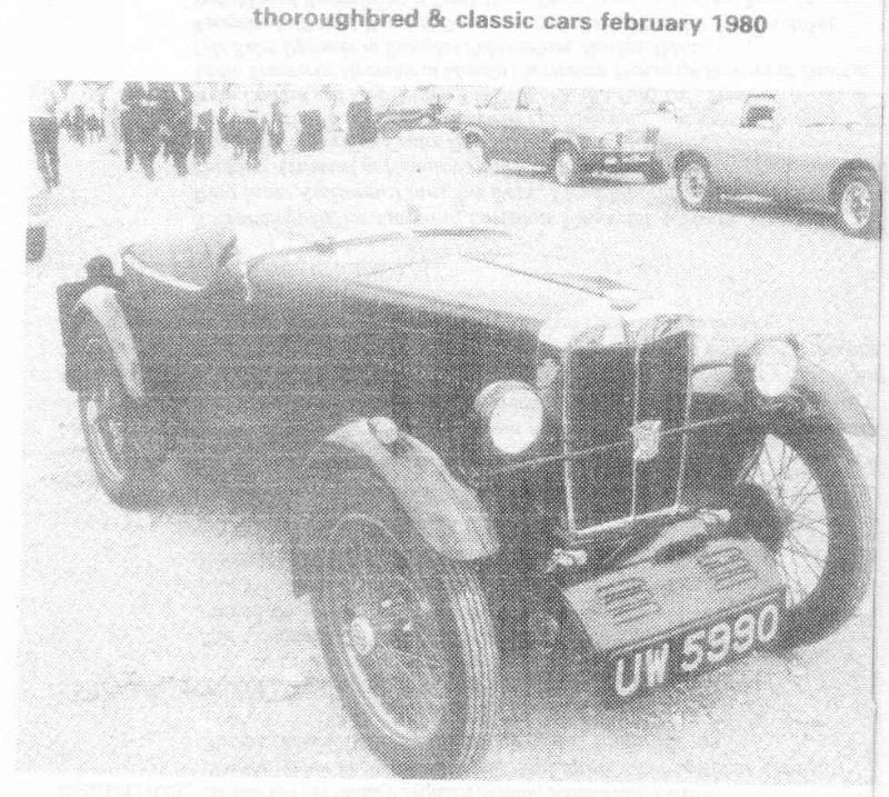

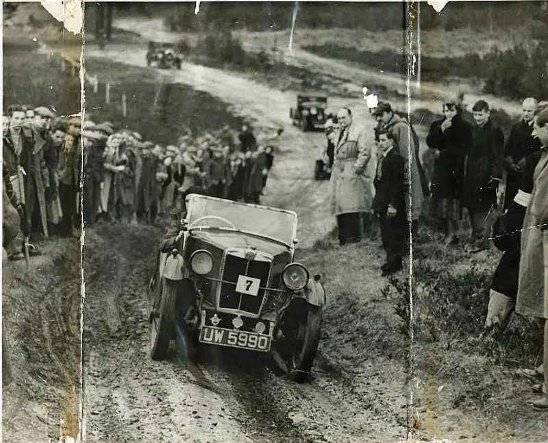

Some of you may recall we traced my late Dad's M Type. In more recent times it has been restored to what resembles a factory offering ...but in this old photo of the car competing in a VSCC rally, I noticed how the flat screen and off centre side lights mounting seem to resemble features found on a Jarvis body.
Could I be right, or not?
I have no other photos, so this is all I can post.
Many thanks,
Ray.

That screen is much simpler than the Jarvis windscreens I am aware of

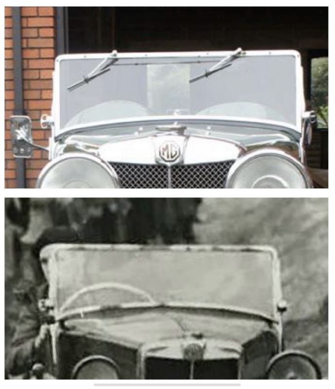

The windscreen in the first picture looks rather like a J2 screen with the strengthened side supports.

I have downloaded the picture and enhanced it as best as I can. The image is now stored on the website server
6634 Posts
Posted - 02/03/2025 :  16:36:01  Show Profile
Definitely looks like a J2 screen (but perhaps slightly adjusted better to fit the screen to the Scuttle top?)

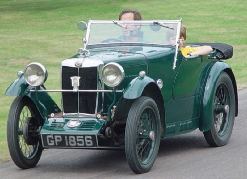

It's certainly not a Jarvis body which is clearly shown in Kevin's picture of GP 1856. Distinguishing Jarvis features are the shape of the door with a forward bulge for easier foot access into the foot well, long windscreen brackets and 'wing' nuts for windscreen rake adjustment.
UW registration is for London so in an area close to Jarvis at Wimbledon but most Jarvis cars were registered in Guildford with PJ letters and some PL. Rob
