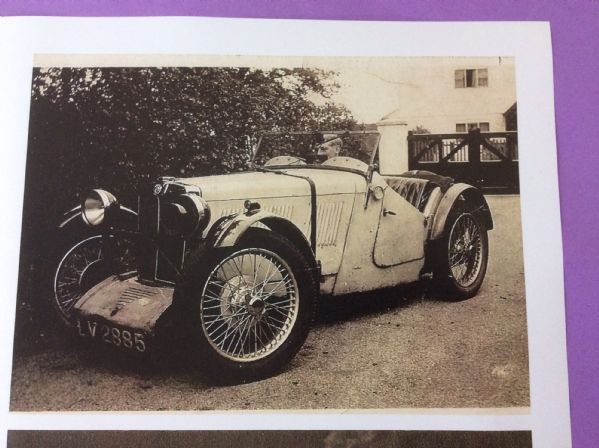

Supplied new to J.B.Roberts Jnr, 30 Aigburth Drive, Liverpool. March 17th 1933,
Colour "two greens".
I am missing the history from the above date till I think late 30s when G McKenzie bought the car, he was a spitfire/ Hurricane pilot killed in the war and then the car went to his Brother R McKenzie who was a Halifax Bomber test pilot based at Speak Airport. I purchased the car last year from the Son of R McKenzie. In the attached photograph taken in the War years the car appears to have had quiet a hard life , I will try an attach another photograph of the dash board which shows extra over instruments and lots of switches. I can only assume tant maybe the car was trialed between 1933 and the late 30s.
If anybody can shed any light on this it would be much appreciated.

Another photo, this one is Gordon McKenzie prior to 1941, there seems to be a number of early photos of J's with cross bracing , any ideas why? Interesting the light difuser is on the driver side in this photo and on the passenger side in the previous photo?

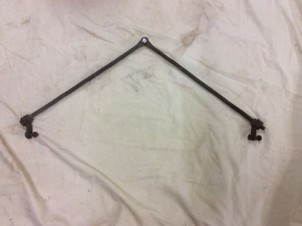

Ashley,
I have also been pondering the use of bracing on the front end of J2s as seen on JES Jones's car on page 77 of "75 years".
When restoring the front end of our ex-Bastock J2 (J2594) I had just the wing stays attached and, when leaned upon, I was amazed at how much the chassis twisted between the front spring mountings. The triangulated cross bracing would stiffen it up because the wing stays are very robust. I found our badge bar was a 5/8" solid bar whereas my good friend Chris Nowlan thinks it was originally a tube. If a tube was being stressed at its junction with the wing stay I imagine it would soon break. Our solid bar does have indents to locate it properly with the wing stay clamp bolts to stop it sliding out. When leaning on a wing stay with the badge bar installed I could not deflect the chassis.
Particularly in trials usage this would be a stressed area and could use the extra help. So I learned that the square represented by the wing stays and badge bar do more than hold the wings and badges.

Chris,
That's really interesting, I am missing the cross tube on the car but I have the cross braces but not the clamp as per your photo. If your clamp was rotated by 90 degrees it would fit perfectly with my cross braces. These fit perfectly on the front most bolt on the wing stay where it bolts to the chassis. The cross braces are a bit "Heath Robinson" in there manufacture but must have added rigidity.

The original was indeed a cross-tube, clamped in the wing-stays. This pulls out or breaks fairly easily with enthusiastic use. Cross-bracing is one solution, another is to fit a 1/4" bar with tab ends behind it, secured directly to the clamp bolts. These will eventually break as well. The solution MBH eventually used was to simply a 3/4" tube with the ends flattened & secured using the normal clamping bolts. 30 years plus now, with no breakages....

Hi Ashley,
I may also have the stays, I recognise the end brackets, I know I have those, thanks that has identified these for me also.

Maybe the extra switches and instruments are the result of an RAF pilot employing his spare time with access to RAF stores or wrecked aircraft? Note also the paint colour change and possibly a front number plate change?

Matthew,
I think you could be correct, the toggle switches do look very Military like and removing layers of paint it shows the car was painted in a duck egg blue/ grey which I am sure would match the colour on the underside of a Hirticane
