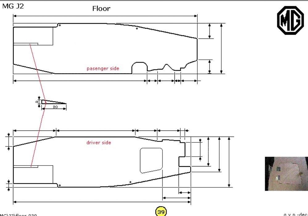

Information please...
Is there a dimensioned drawing anywhere of J2 floorboards including the hinged hatch for brake adjustment? The forum has a drawing of PA floorboards. The mgmmm website has a drawing of J2 floorboards but I can't see any dimensions (see attached) for the size and position of the hatch even though there are arrows indicating where the dimensions should be. Am I missing something?

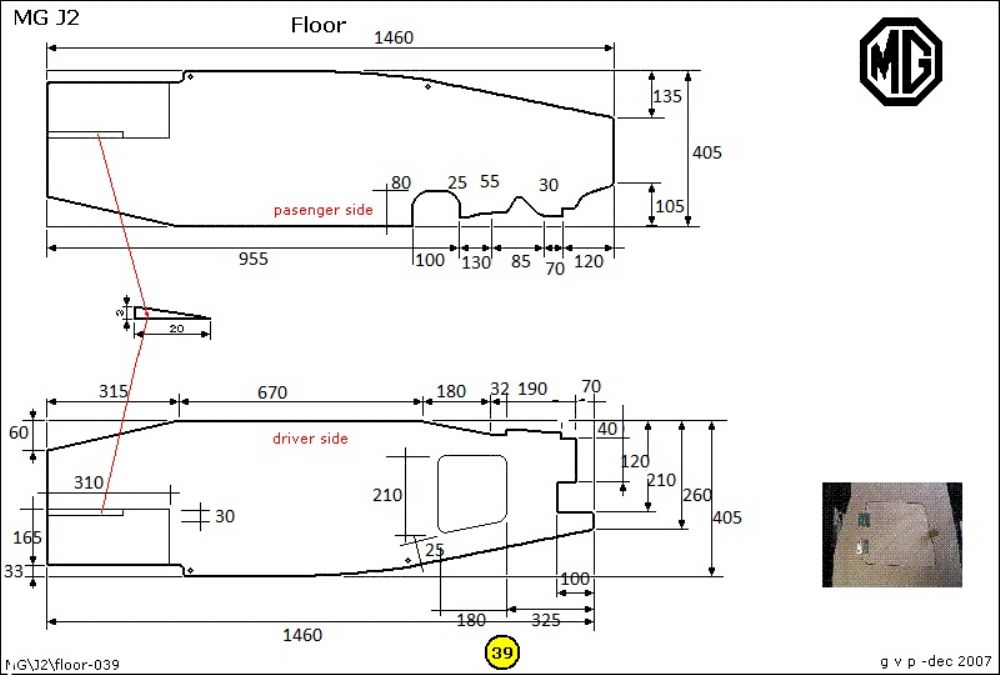

Hello Nigel,
I have just completed a new set of floorboards for J3435 and still have the original set. I did not make drawings of the old boards but rather used them as templates. I will take measurements and also give you a picture of the hatch.

Hello Nigel
Here are the dimensions of my floorboards as dismantled. They certainly need a bit of adjusting to get a good fit!!

Denis
This is brilliant. Thank you so much. I note that the steel hinges are simply laid on top and screwed down to the board/hatch. Obviously it was cheaper for MG to mount the hinges this way rather than to edge-mount them, which would have looked neater!
