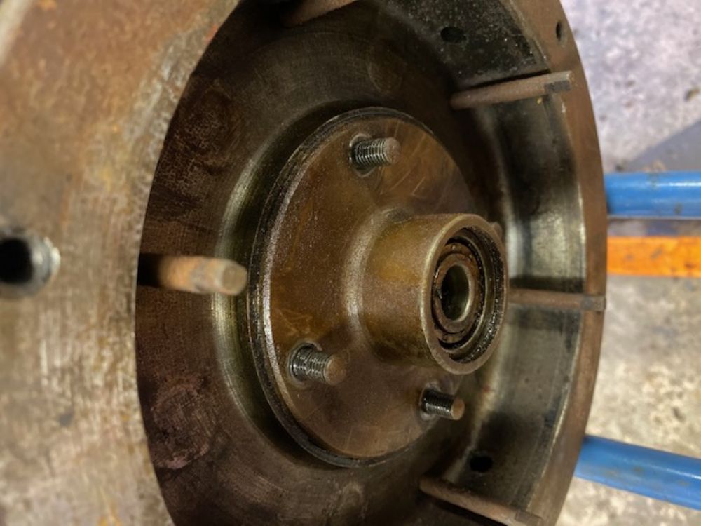

In stripping my 1930 M-type engine, I have encountered a problem. What I thought to be simply the cover holding the spigot bearing, I found it was well and truly stuck to the flywheel. I have managed to separate the flywheel from the cover, but I now find that the "cover" is actually stuck to the crankshaft and may form the inside taper over the end of the crank.
Since there is no way to get behind neither the "cover" nor the flywheel, and the flywheel housing bolts are behind the flywheel, the question is how I can separate the flywheel, the "cover" and the crank.

Same on the J2. Remove circlip and spigot bearing to expose large nut, remove nut, apply special puller to bolts, screw in forcing screw and hope flywheel and rear bearing flange move backwards.

Looks like you've removed the 'cover' and I think the photo also shows the circlip has been removed. If so, you now need to remove the spigot bearing (you may need an internal puller). Then remove the locking bar which stops the crankshaft nut undoing. Then undo the crank nut a couple of turns. You'll need a decent puller that fixes to the 4 studs. A bit of brass inbetween the puller end the end of the crank will protect the thread if you are intending to re-use the crank
Flywheel and boss come off together.
Easy with the right tools and know-how. Easily butchered without.

Be careful not to loose your "nutless bolts" through the flywheel. I would put nuts on them while you are waiting to do the next stage. They should be interference tight but I have had some that are worryingly loose and are inclined to disappear through the flywheel. As you have found out if they disappear you can't get them back! You will probably need all four bolts to hold the special puller which may need a lot of torque and clouting on the end bolt to release the flywheel from the taper.

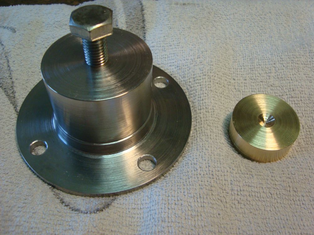

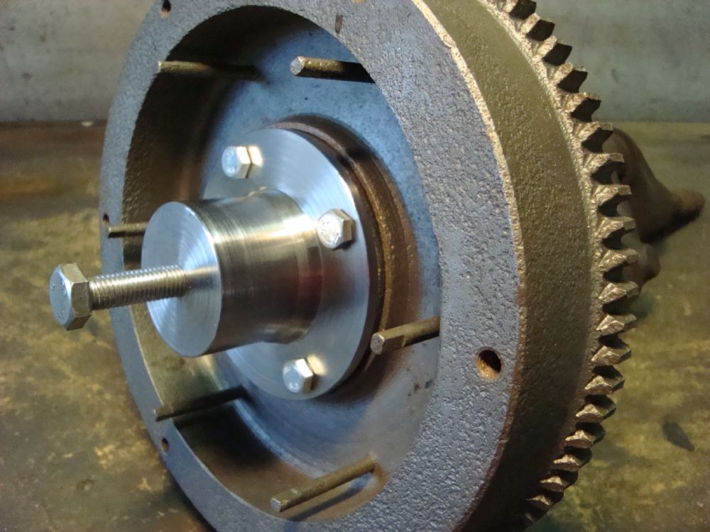

I made a Flywhell puller for my M types

Jorgen,
nice bit of kit... but confusion... it seems to be bolted on, I would have expected to see nuts on that side rather than bolt heads.
