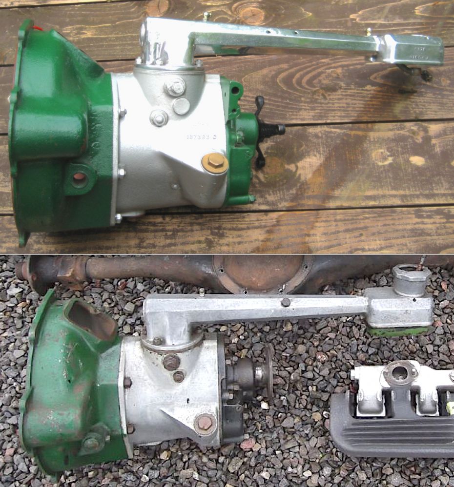

kimber
1446 Posts
Posted - 08/05/2021 :  08:57:02  Show Profile
I have a spare J2 gearbox c/w remote and excellent internals. Would advise new bearings. Currently assembled. £1,500
