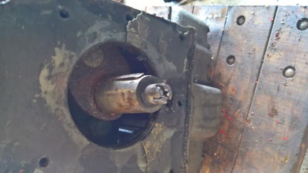

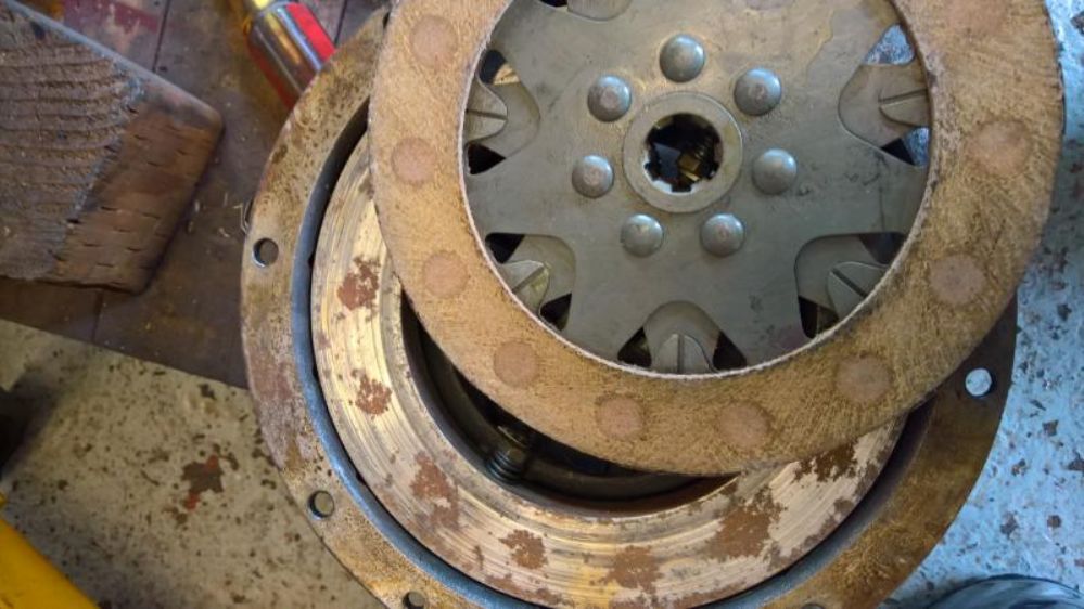

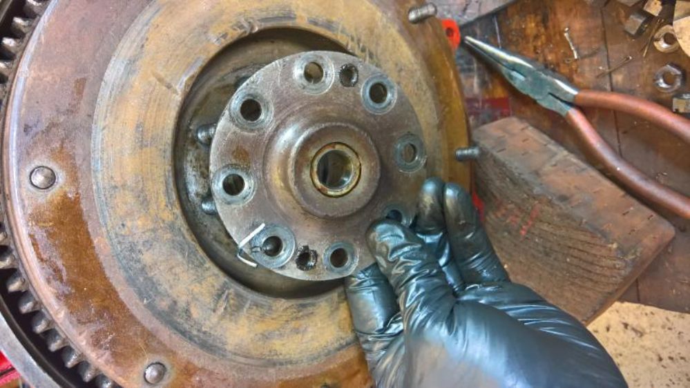

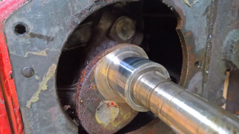

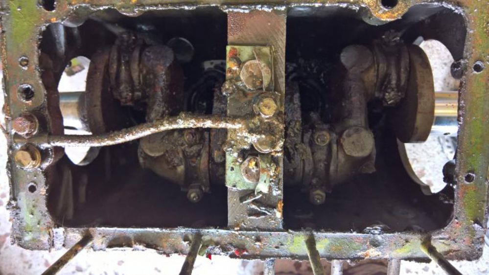

I have sent the engine of PA 1024 out to a specialist to look over and rebuild. After sitting there the last three months the "Tomb" has been opened. The shop sent me these pictures late on Friday afternoon.
So the crank etc. are rusted now as the car has been sitting idle since the 1970's. Looks like the block has been sleeved as well. Have any of you dealt with this much decay and recovered the engine? Engine was frozen when I started but now they have been able to take completely apart.
Your thought's...

3213 Posts
Posted - 06/05/2017 :  22:21:03  Show Profile
Yes, Brian. I have seen worse on my own PA and PB Airline. The PA cylinders were cracked and rusted badly. They had to be completely broken out and replaced with wet sleeves. The crank was badly rusted and the journals were .065 under sized. The cam was a ball of rust, and the block was cracked in several places. Nonetheless, it was brought back to life and now runs well.
The PB pistons were solidly glued to the cylinder walls. There was what looked like black foam rubber in the sump. After figuring it out, it turned out to be congealed oil, on its way back to being a dinosaur.
So take heart, almost everything can be replaced if need be. All it takes is time, money, and determination. You never thought restoring one of these wonders was going to be cheap and easy, did you? But in the end, it is worth it.

Hi Brian,
It just looks like a normal grotty old engine to me. Get everything dismantled and cleaned up properly before making any decisions.

Posted - 07/05/2017 :  00:54:38  Show Profile

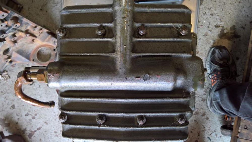

Hi Brian
Might be surprised when all carefully stripped and cleaned down, could well be mostly OK. The big test is crack testing. Almost anything is repairable to at least a certain degree as mentioned in the discussion, or depending on budget. Sump looks good, nice to keep the original magnesium sump if possible I reckon too.
Agree very much worth the effort. Local PA owner just about completed his engine from a similar condition and time in storage. Start-up day soon, very exciting indeed.
Following your engine progress with great interest, do keep us posted!

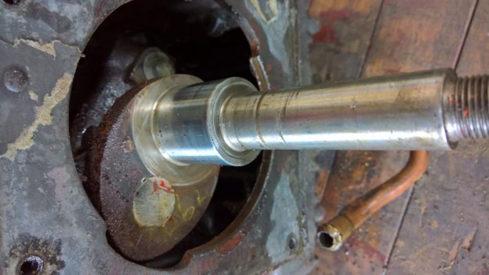

Posted - 09/05/2017 :  01:15:39  Show Profile

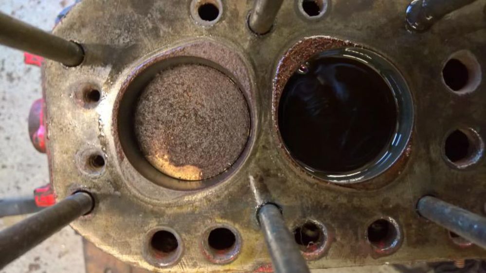

Hello Gents,
Went to the specialist shop this afternoon and reviewed the engine. Turns out the white metal and all bearing surfaces are in fine condition. Looks as though the last one to do machine work on the block, crank and white metal surfaces did a fine job. Evidently though the one assembling the engine pounded things back together as the strike marks show where hit with an object to re-assemble.
appears at this point that the engine was rebuilt and then left to sit without running since the 1970's.No oil on crank case parts caused over time to rust.
The block was not lined in the past. The steel rings were frozen in the bore but came loose with one ring breaking on #2. All in all came apart nice and clean. They are crack testing everything and if ok and the block pressure tests fine it should be just a clean up with new rings and honing and then back together. The specialist is testing hopefully this week.
Have hopes of good news but will deal with what is found as it need be.
