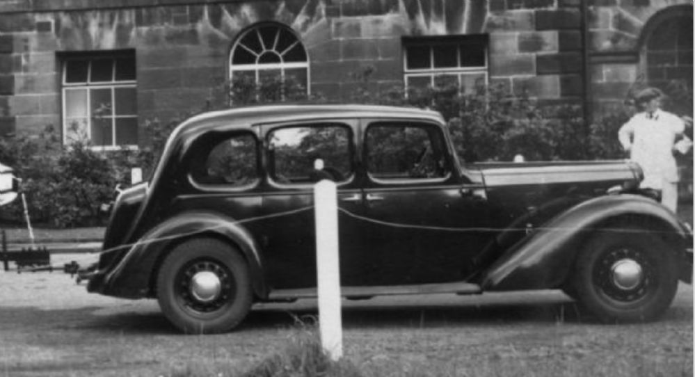

I think we can definitely say it’s a Fourteen with the longer bonnet.
Fourteen
Twelve
